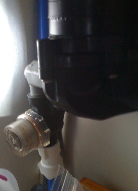

I'm talking about the one under the galley sink that's attached to the Shurflo pump. The one I have is an inline, which is a pain to clean. I want to put in the bowl type that can easily have the screen removed for cleaning. I need the part number of it, if anyone's replaced it.

Ed, is this what you are asking about? It is the fresh water filter inline under the fresh water pump. It is all located under the galley sink. Hopefully, the photo will help you find the part number. We have a Shur Flo, Aqua King, Product #: 3901-0206 or 3901-0216
