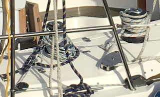

- Hans v. d. Weijden
- Posts: 10
- Joined: Mon Nov 23, 2015 3:27 pm
Re: Traveler and Genoa Furling Line
Kevin,
When the wind pics up it will be very difficult or even impossible to pull in your furling line without using the winch. You have a 50% change the starboard winch is already in use as described by Bill.
On my boat this problem is solved with an extra winch and line clutch. See the picture I attached. I am away from the boat the coming weeks, so I can't get a better picture at the moment. So I hope this picture is clear enough to show how the furling line is running.
Hans v. d. Weijden
The Netherlands, Ermelo
Hull 254, Swan
hans.van.der.weijden@hetnet.nl
Hans v. d. Weijden
Hull 254, Swan
- Extra winch for genua.png (140.76 KiB) Viewed 12235 times
I am looking to put a line break on the jib furling line like the one pictured on "Swan". What I'm struggling with is how to access under the deck to secure the through-bolts for the Spinlock clutch. The line on Peenhonin is on the port side which is not easily accessed. There is a a narrow panel that can be opened to give access to that area. However there are a number of cables running through there and I am not sure how to safely drill through there.
Has anyone added a furling line block on at 2008 port routed furling line. If so how did you calculate where to drill through?
