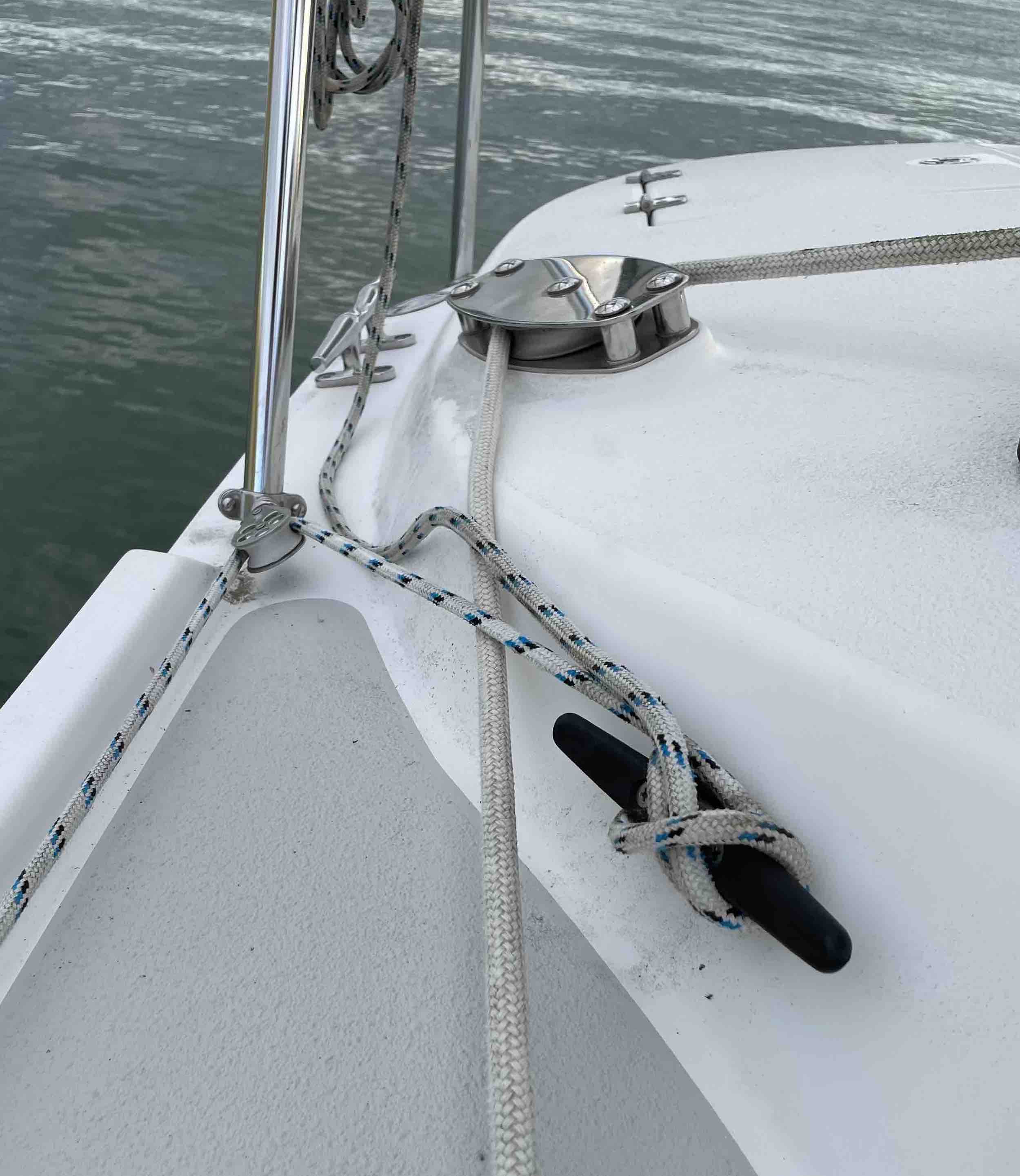

Kevin, I just left the 2 bullseyes attached to the coach roof. I've never had a problem with them in the past 15 yrs. The stanchion block are from Garhauer. I positioned them on the outboard side of the stanchions to avoid scratched ankles. The furling line would probably lead a bit more fairly if positioned inboard. The cleat is through bolted but I did not use a backing plate.

Ditto, exactly same set up as Ken, have thought about removing bullseyes and replacing with purpose made SS polished plates, but haven't tripped on them in the 6 or 7 years since made the change so have never got around to it!

Ken - thank you for those pictures, I may give that a try. Final question, do you have any problems with the furling line crossing the genoa sheet when the genoa is reefed (both lines under tension)?

I've had no problems with that arrangement. When the genoa is furled, I lead the furling under the sheet and it works fine. You may have to experiment with the vertical position of the last turning block on the stanchion and the cleat to get a fair lead under those circumstances.
