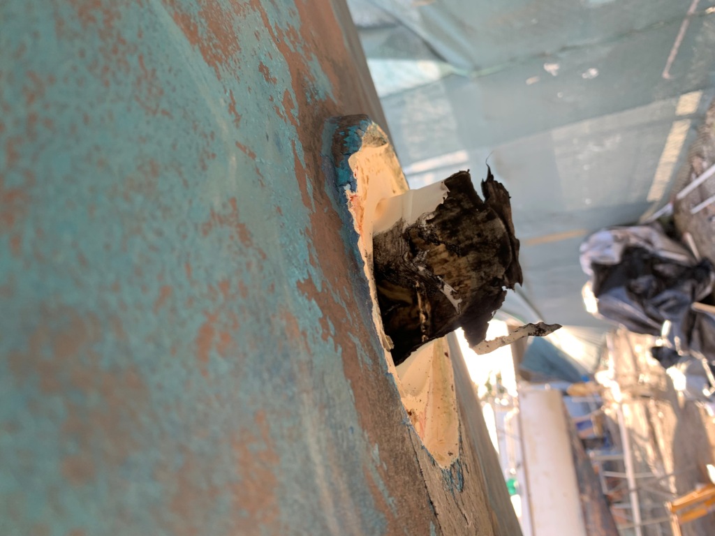

Firstly the keel; the solid nature of the lead keel made it a simple affair to gently tap some displaced lead back into place. We then followed the instructions in the West System manual to cover the lead which was exposed. Here is a picture of the back of the keel showing the lead protruding to the left:
A ball pean hammer is all that is needed to gently and slowly tap the lead back into shape.

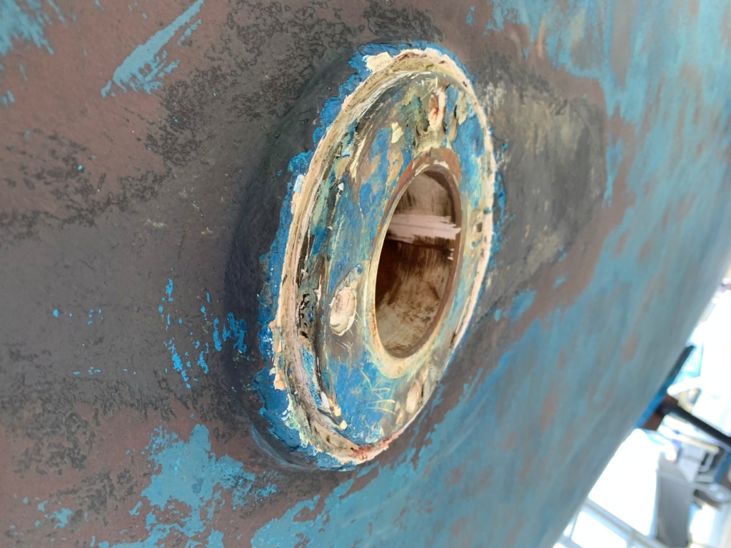

Now if anyone has tried to order a replacement rudder bearing from CD lately they will note they are not available. In Australia there is no alternative available so we had to adapt. A call to our local milling and engineering firm resulted in them assuring us they could turn new bearings from the old using a rod of Delrin material. So with that in mind we dug a hole and dropped the rudder. All good so far. Then it was time to remove the bottom bearing and it did not want to come out! So after removing the middle and upper bearings we then attacked (the right word) the lower bearing using a bar and four pound hammer. Many whacks later it started to move and finally the 5200 or whatever was holding it in started to slowly relent. Eventually the bearing slid down bringing a thick film of (presumably) 5200 with it. interestingly there were only two of the four screws used in the bottom bearing left in place.

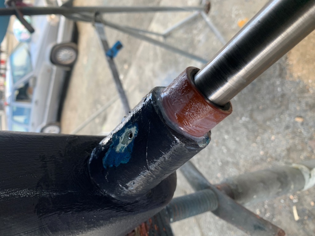

Here is the bearing in place with some hack saw cuts in an attempt to coax it out:
And some after shots of the bearing sleeve with the 5200 still hanging down and yet to be cut away.
After cleaning up the bearing sleeve it was apparent we had removed some fairing/glass around the tube:
And this had to be faired with epoxy prior to installing a new bearing.

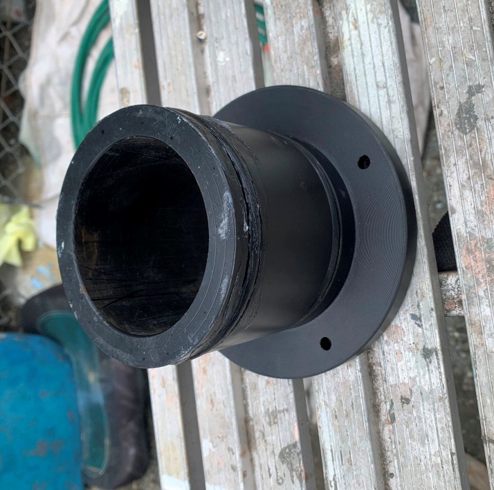

True to their word Ansell Engineering came up with a new bottom bearing, part of the middle bearing and shimmed the internal of the top bearing. We also decided in consultation with them to not put any sealant into rudder tube but to use o rings in the bearing outers there by not requiring any form of sealant. inside the rudder tube.
New bottom bearing:

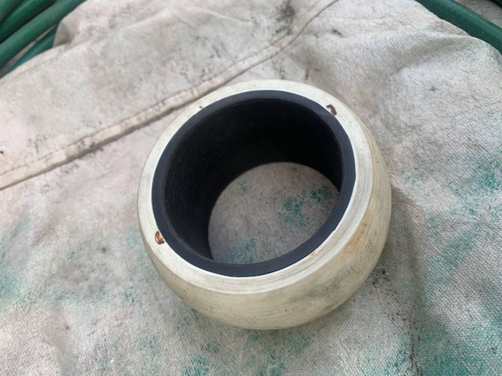

Whilst we had no leaks at the PSS seal and the shaft bearing seemed tight, after all of the pounding on the shaft to remove the flange we decided to replace the bearing as well. Turns out it was burned in places.
New Cutlass bearing:
