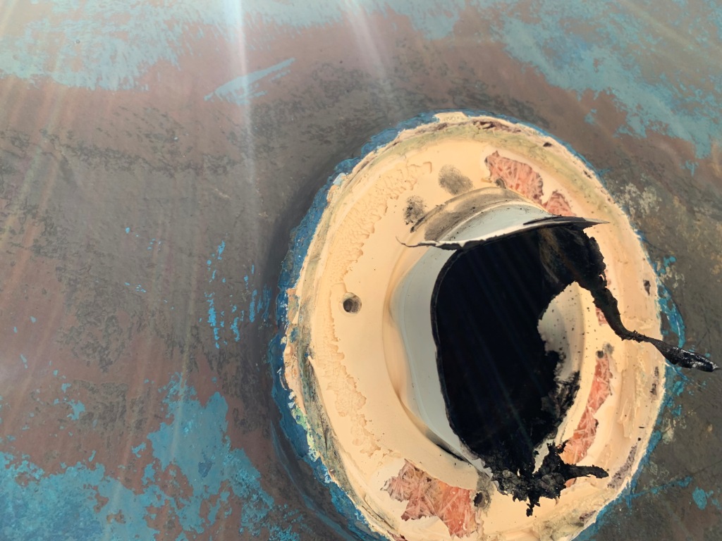

And some after shots of the bearing sleeve with the 5200 still hanging down and yet to be cut away.

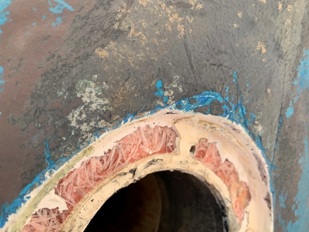

After cleaning up the bearing sleeve it was apparent we had removed some fairing/glass around the tube:
And this had to be faired with epoxy prior to installing a new bearing.

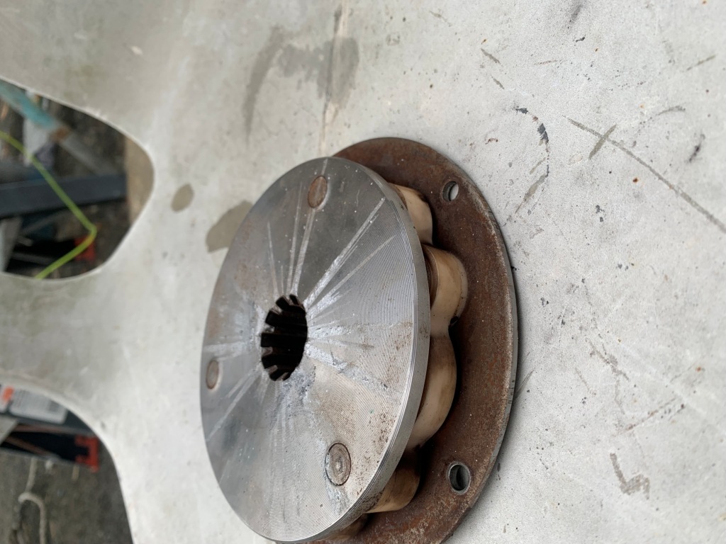

Next we figured we would replace the engine damper based on a rattle at idle that disappeared at higher revs (we have about 650 hours on this engine) as well as lots of black and brown dust toward the rear of the engine compartment floor. At this point the guys from Ansell, pointed out the PSS seal was at least 8 years old based on the fact the inlet connector for the cooling water was plastic not metal. So we included the PSS seal in the deal. This lead to a day of coaxing the shaft flange off, but enough people have covered this problem in detail before. Suffice to say - what a pain.
Of note the adapter plate appeared to be in pretty good condition and I suspect we will not see much improvement with its replacement oh well:
