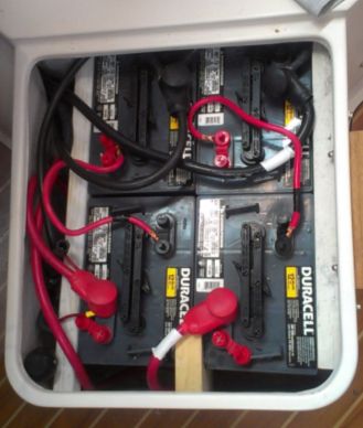

Thought I would “close the loop” on my battery situation….replaced both house batteries this weekend. The job was surprisingly uncomplicated with the hardest and most time consuming part being changing the configuration of the “hold down” wooden slats as the existing ones would not fit across the new batteries. I opted to replace the 2 Nautilus 4D 12v batteries (6+ years old) with 4 6v golf cart batteries. I went with the Duracell EGC2 for the new batteries. They were easily available at Sam’s Club for a reasonable price; their specs compare favorably with the Trojan 105s which many seem to use (getting Trojans would have involved more time) and they are manufactured by Deka/East Penn which has a good reputation (I’ve had good experience with their batteries before)- and they weigh a lot less than the 4D! Considered AWG’s but balancing expense, availability, size & how we use the boat, went with the wet cells –maybe next time. After reading many posts, we were dreading getting the large 4Ds off the boat….contemplating everything from using some sort of ramp to push/pull them out of the boat to using the spare halyard to hoist them out. We were pleasantly surprised to find that after getting them out of the battery box by tilting them on their long axis, 2 of us were able to lift them using the handles on the battery. We covered all surfaces and carefully lifted from the cabin deck, up a step at a time to the cockpit and then up to the gunwale and off the boat to a dock cart. Yes, they were heavy, but being careful to lift with legs and not back it wasn’t near as difficult as we’d imagined! All in all took about 20 minutes. Putting in the 4 golf cart batteries was quick and easy. Wiring them required 2 jumper cables – I only could find 4AWG gauge cables so used them, but have 2 2AWG cables being made and will replace them next week. Easily the most difficult part was reinstalling the braces and “tie downs.” The Durcell battery has linked fill caps, so reinstalling the wooden braces across the batteries would not work. Took some "thinking" and and a trip to Home Depot, but we were able to install braces along the length of the battery and a new block at the foot to lock them into place. That took some sawing, and drilling new screw holes.
After turning the switches on, had power, voltage was within expected ranges, the battery charger seems to be working OK (though I may do some more checking on that before I leave it on). Will be checking electrolyte levels regularly and will see how things go!
Thanks for all the insights and suggestions!!

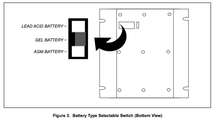

Fat Cat, there is a switch on the back of the charger that will allows you to select AGM batteries. Don't ask me who the genius was that decided that the entire charger had to be unmounted in order to switch battery types.

Thanks to both of you for the good advice. Sadly, I have no literature on this battery charger and never would have found that switch. I'll let the electrician know, maybe the battery charger is still good. Now... when you leave the dock and have all other breakers off, do you leave the charger running? Does this charger provide a "float" charge, or does that only happen on newer Charles 30 models?
Re: YET ANOTHER BATTERY QUESTION
Fat Cat - I believe you may have the Charles 93-12302SP-A charger. If so, here's a link to the owner's manual. It's really geared towards installation but you might find it useful - http://www.charlesindustries.com/marine ... argers.pdf
