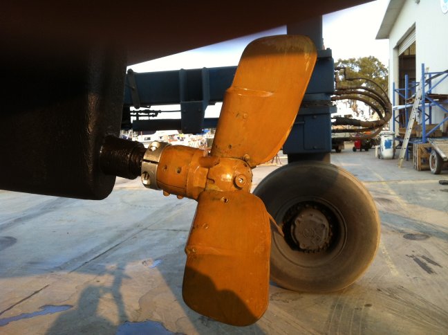

I know there has been plenty of discussion about the Kiwi prop in past postings, but I have just fitted one and have problems and wonder if anyone else experienced similar.
The manufacturer had full specs for engine/gearbox/boat from me, and claims to have lots of previous installations in Catalinas, so I assumed that the setup of the prop (i.e. diameter and pitch) would be reasonably well suited to the boat as supplied. To my dismay:
1) WOT is now 2000 rpm so it is massively overproped as supplied (I know I can adjust the pitch if I can find a diver or lift the boat again)
2) almost non-existent vibration or engine shake above 1400 rpm with original 15x9 sailprop is now vibration through the whole hull and rigging - installation was done with oversight of a marine mechanic and the boss fitted the shaft perfectly so definitely not loose or off-centre. The dealer painted the prop and blades with Propspeed prior to delivery so I am assuming that doesn't put it off balance.
3) when engaging reverse (idle is around 1000 rpm to reduce damper plate chatter and engine vibration) there is a pronounced "bang" which is scaring the hell out of me and making me think of bits of gearbox all over the boat.
I can return for refund within the first 30 days, but that puts me out of pocket and still with problems of original 15x9 sail prop. Any thoughts gratefully received.
- New prop and machined donut anode just before going back in water
- Kiwiprop.jpg (54.91 KiB) Viewed 36506 times

Re: Kiwi Prop
I'm assuming that the pitch shown in the picture is not the way in went into the water? That is the feathered position? Please clarify.
russp wrote:I know there has been plenty of discussion about the Kiwi prop in past postings, but I have just fitted one and have problems and wonder if anyone else experienced similar.

The first thing you need to do is get the pitch adjusted down and then see where you stand. A guy I know was over proped with first a Gorie and then a Flexofold and with both he got substantial vibration as he throttled up and he wasn't as over proped as you appear the be if WOT is 2000rpms. What size prop did you get and what is the pitch set to?

Hi Ed, yes can confirm that when I took the picture the blades were in the full reverse position (in which it looks more like a fan than a prop - the guys in the slipyard couldn't believe a prop could work at all with that much pitch). Kiwi state that you do run the revs much slower in reverse, and that the prop can overload a smaller motor and you can see why!
The boat does reverse with this prop, and at very low revs, but it has a huge amount of propwalk, more than the 15x9 I took off, whereas some previous posts said the prop walk was reduced with the change to the Kiwi so I am quite confused at present.
Thanks for your comments Alan, my receipt says they delivered a 16x21 deg RH 1" and therefore identical to yours (in spec at least). How on earth can they be so different? The blades must be going to the full forward position as they moved easily with gravity when rotating the prop in the yard
I am waiting on comment from Kiwi Prop, haven't heard in 2 days but hopefully they are thinking about it. Until I hear from them I am not going to start adjusting the pitch as it should be correct as it is.

As I recall the prop goes in reverse and backs up against the spring. This allows the prop to assume a more realistic pitch.

You are correct of course Leigh, I spent some time last night on the Kiwi Prop site and read up on how it reverses and while you can't "see" it in reverse pitch when stationary on the boat, it obviously works once water pressure is on the hub/spring mechanism through the blades.
I got down below this morning when it was being put into reverse and was relieved to hear and feel that the loud bang (to my ears) is in the prop and I couldn't feel it in the gearbox casing so presumably that is the spring hitting the stops in reverse. I hadn't heard any mention of this from other owners but Kiwi Prop have since confirmed that there is an audible "knock" when the reverse dog engages, but presumably most owners don't notice or don't worry about it.
The KP guy suspects that I only have a 30 HP M35 or M35A but all the documentation I received with the boat confirms a 35B with 27 kW or 35 HP so no logical reason there for the 2100 rpm WOT, and at 1200 hours and no apparent damage to any part of the engine no apparent reason for any power output restriction. We just fitted a new exhaust riser and hose and looked into the exhaust manifold and nothing untoward has happened in there. So at this stage a mystery I am still working on.
For interest, my mechanic sand blasted the inside faces of the riser, there was extensive pitting on the discharge side and he noted small white crystals in the corresponding face on the dry side that he says is salt starting to weep through the metal even though there appears to be plenty of metal left. To be safe I bought a new riser.

If you replaced the 15x9 three blade fixed blade prop with a 16x21 Kiwi, then it seems that you have over done it a bit on the pitch. I don"t know what my pitch is now because I adjusted (fine tuned ) it in the water. I think you have to do the same.
I also lowered the idle to 900 RPM (with an optical calibration tachometer), after the new HD flex drive plate, and the "Clunk" is not as pronounced.
Remember to check the front edge of each blade to the hub seam, making sure that the visual gap distance is equal for blade pitch balance. I adjusted my pitch first with a full turn of the screws, (easy to see with the wrench in the water) tested, and readjusted. I wanted to go past the optimum point and then fine tune at 1/4 turn per readjustment.
Please keep us informed with your progress on your quest for engine speed, smooth and quiet.

Thanks very much for the information passed on Geoff. There is an ongoing uncertainty about all of this. The Kiwi Prop supplier is sure that my 16" prop left the factory set to 21 deg and therefore by your experience it should draw less power than your 16.5" set to 21 deg.
However, we ran trials yesterday in flat water and the M35B and Hurth 1.88 reduction gearbox combo on my boat tops out at 2300 rpm and about 6.3 knots and the engine is working hard but otherwise seems in perfect order and I had a diesel mechanic on board. Thus 21 deg pitch is still too much and next step is to knock it back.
I am also planning to cut the idle speed back (it is high to prevent excessive engine shake at idle and breakage of alternator mount, heat exchanger mount and fuel filter mount - all had broken or broke soon after I purchased the boat and nothing since I replaced them and upped the idle speed). I can start to use the throttle instead so that I only allow the slow idle for moments between gear changes and keep away from it the rest of the time. It is logical that a high idle speed will increase the impact when the rotating hub/spring combo in the prop hits its stop.
The further I look into this the more I accept that the "small" and quite light 15x9 prop that comes with the boat allows for a certain degree of misalignment or off-centre to be tolerated but it would appear that the heavier hub of the kiwiprop accentuates any imperfections so I may have to go through and do a complete alignment/balance/damper replacement/PSS maintenance kit install all at the same time, and with luck and good management she will go back in the water as smooth as silk.
The amount of water pumped in reverse is massive compared to the 15x9 sail prop and I haven't even had a chance to explore the improved sailing performance yet.
Again, many thanks for the input, most things are starting to fall into place, this has just turned into a much bigger and more expensive project that I was anticipating (but then again, what to do with a boat doesn't!!).
