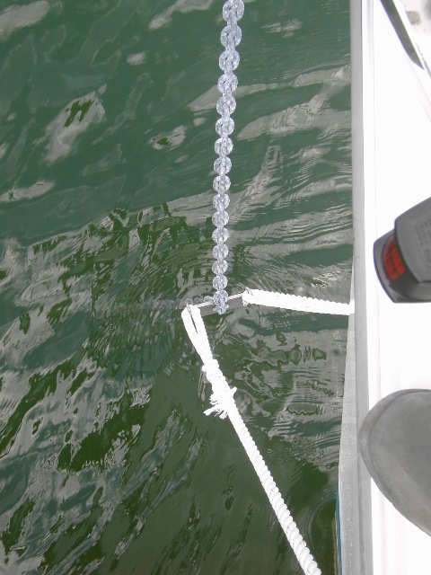

I have to second Wolfe10's comment. I learned long ago , not to hard attach the all chain to the boat. You have to have some type of snubber to absorb the shock loads whilst on the hook. I custom made a "V" plate with two lengths of 5/8" line to hold the chain. Think of a plate with a notch in it to receive the chain and then two long rabbit ears of rope. The two lines then get tied off to the two bow cleats. Works like a charm. If I apply the system from beneath the chain, it all falls off when weighing anchor. We've used in at anchor in over 50kt winds and 6' seas. ( Really! )
As for a hard stop when the anchor is bedded, we use a trucker type heavy duty bungee that we switched out the cheap steel "S" hooks for good stainless steel ones. Been in service for 4 years now. Bring the anchor in, stretch the bungee and clip it into the chain. Not even the worst seas have sent the anchor over.

- Not the best angle, but here's the "V" in action.
- PICT2719.JPG (106.23 KiB) Viewed 17091 times
