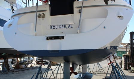

We had a bottom job in January (Pensacola Shipyard). We brought the waterline up the stern to account for the boat sitting low in the water (A/C and genset weight). It is sooooo much better.
- 20120126_4052_web.jpg (78.51 KiB) Viewed 19049 times
Re: Help Changing Waterline Stripe
Very good. If you ever want to return the white stripe between the bottom paint and the boot stripe, you can use 1" white tape made specifcally for this available at West Marine. It's inexpensive, lasts for many years, and is simple to apply verses painting on a stripe.

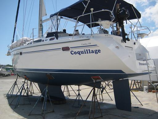

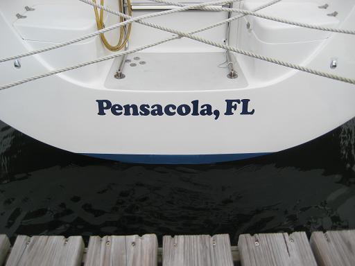

Thanks to everyone for all the good feedback on raising my waterline. I finally decided to keep my original blue boot stripe and white waterline stripe and just wrap the bottom paint around the stern. The Admiral thought that would look best. It appears that will work just fine as my boat does not have a gen set or dingy on the stern. Attached are a couple of photos of the results before launch and one afterwards.
