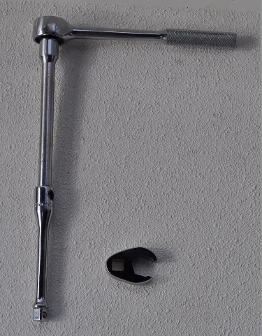

I "made" a tool to allow me to drain from the lower plug, mostly extensions and a flare nut crows foot to grab the plug. My arms just won't do the job in the small space otherwise - if you need a photo of the tool, lemme know.

Attached is the image of the tool that I use to get access to the bottom sump plug.
As for the washers, they go between the two ( top and bottom ) plugs and the body of the gearbox. They are not "normal" washers - rather they are made of a sintered metal that crushes down when you tighten the plug and thus make the seal. That's why they are a one use only item. I got by, for a bit, with some high temperature engine silicone to make the seal, but got a proper washer in place ASAP.

- This combination of pieces allows you to work the plug at the bottom of the sump of the transmission.
- Wrench.jpg (87.82 KiB) Viewed 20721 times

One more point... that is not a standard crowsfoot wrench - it is a Flarenut Crowsfoot. If you look closely, you will see that there are two small "teeth" that are machined into the opening of the wrench - that is so it will grip all six sides of the Flarenut - usually pretty soft brass and easily deformable if you used a standard wrench. As the plugs are made of aluminum, and the position you have to get the wrench into to do the job is difficult - anything that would keep the wrench on the plug is most welcome.

Thanks again Al. I agree draining from bottom is the correct approach. The local folks are running some marine diesel hands on classes this winter so I'm looking forward to going back to school.
So far I've not been able to see any drawings on the internet.
I'll look for the flarenut crowsfoot and the washers
Duncan #248

Ken, I got four "near matches" from a Honda dealership and got two "almost perfect" from a marine dealership, the one that did the gearbox replacement. Seems that the actual machining on the gearbox is of such a tolerance, that the Honda ones did not quite fit right, and the marine ones were a tad on the small side.
I mean, what 'cha gonna do when the transmission is made in Europe ?
Liberally use goop! That's what.
I have two left over in my small parts box. Guarding them jealously
al
al
