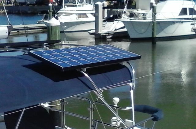

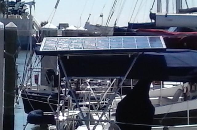

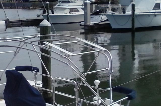

I finally added two Kyocera 140 watt panels and a Blue Sky controller last week and tested them out over the weekend. In 3 days, (2 of them cloudy all day), the house bank state of charge never got below 85 percent. It appears that the two panels will provide about 2/3 of our daily electrical consumption on cloudy days and nearly 100 percent (125 Ah) on sunny days.
Here are a couple of pictures of our installation:
- Structure1.jpg (48.07 KiB) Viewed 36258 times
- Panels2.jpg (43.46 KiB) Viewed 36258 times
- Panels1.jpg (48.21 KiB) Viewed 36258 times
