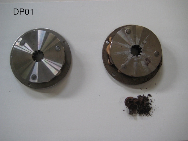

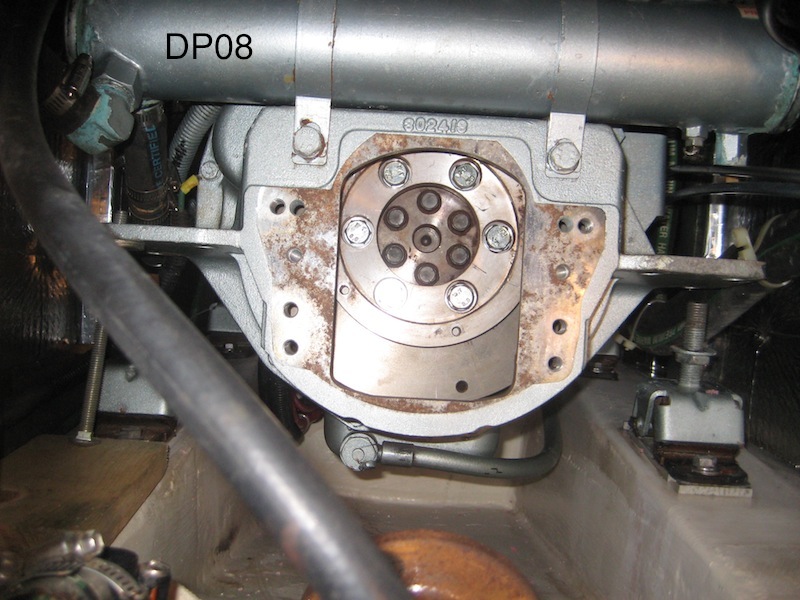

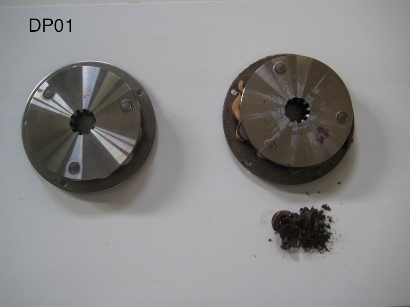

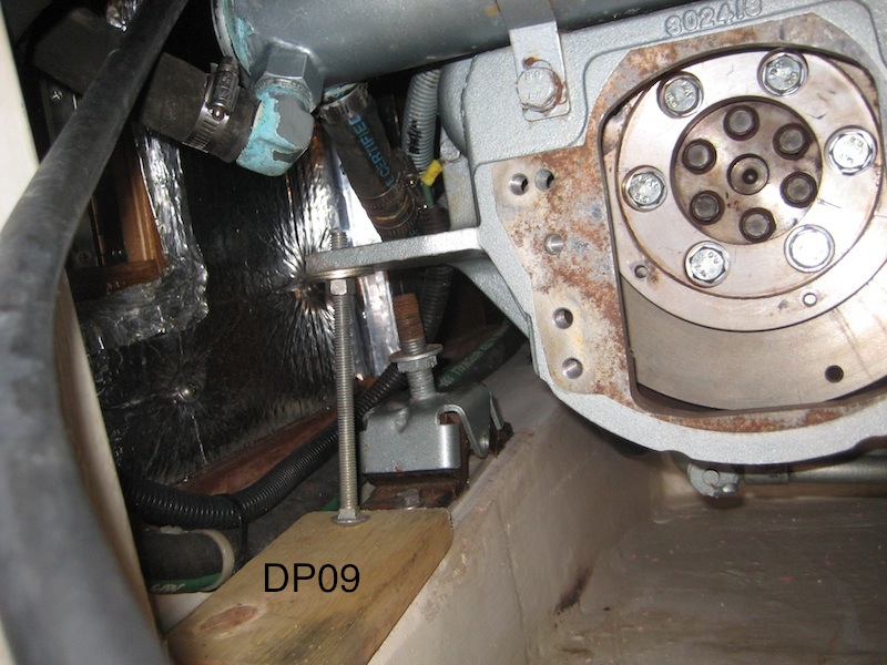

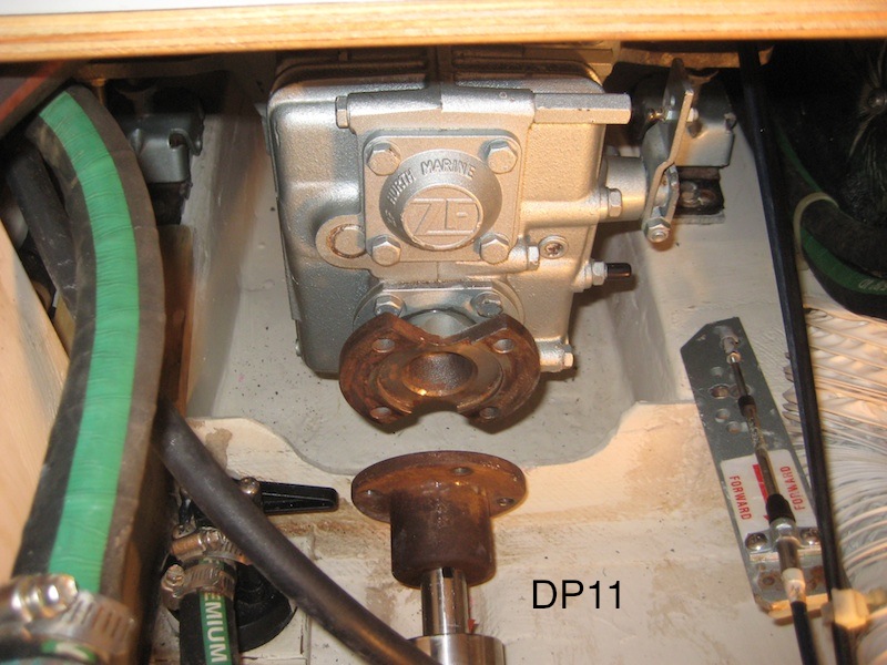

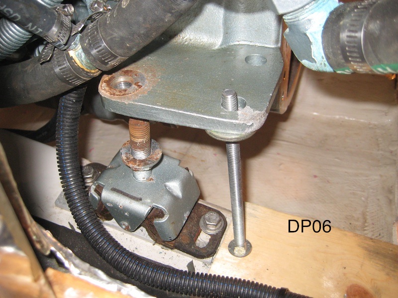

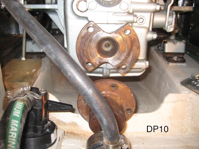

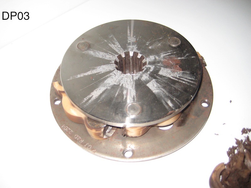

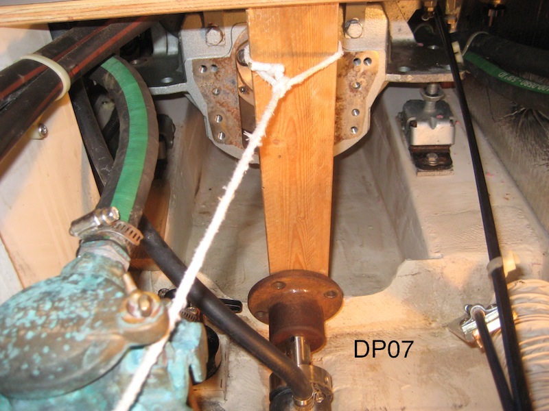

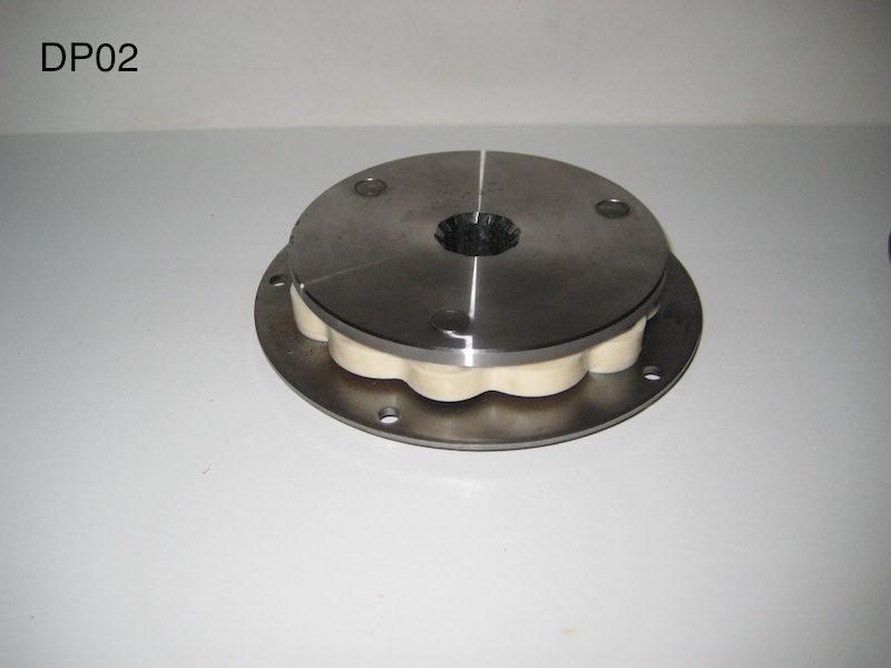

To compliment other posts about the M35B damper plate, here is my experience. At slightly over 700 engine hours, I discovered black/grey power in the starboard rear area of my engine compartment. I first though it was from the alternator belt but not so. Shortly later I noticed a chattering sound in idle that would decrease when engine rpm increased. I think the clattering had been there for some time but I just did not pay attention to it. Based on other posts, I decided the problem was likely the damper plate. I disconnected the transmission output shaft from the prop shaft, raised the engine rear, removed the transmission, and removed and replaced the damper plate. The damper plate has a non-metallic center which was coming apart with chunks in the bell housing bottom. These chunks were being ground into fine power that was blowing out the timing mark viewing hole in the starboard side of the bell housing. I replaced the damper plate and problem solved. Upon request, I will email a fairly detailed summary with pictures of how I raised the engine rear and removed and replaced the damper plate. I did all the work and the damper plate cost $404.32 at R. B. Grove, Inc. in Pensacola. Below is a description of the pictures.
Picture Comments:
DP01.jpg: New damper plate on left and old on right.
DP02.jpg: New damper plate.
DP03.jpg: Old damper plate.
DP04.jpg: Old damper plate showing chunks removed from bell housing.

Picture Comments:
DP05.jpg: Part number tag for new damper plate.
DP06.jpg: Port rear engine mount area showing bolt used to raise engine rear.
DP07.jpg: Wood piece used to keep pressure on dripless seal.
DP08.jpg: New damper plate installed in bell housing.
DP09.jpg: Another shot of new damper plate in bell housing.
DP10.jpg: Transmission reinstalled and engine rear still raised.
DP11.jpg: Another shot of transmission output shaft and prop shaft flanges disconnected.
