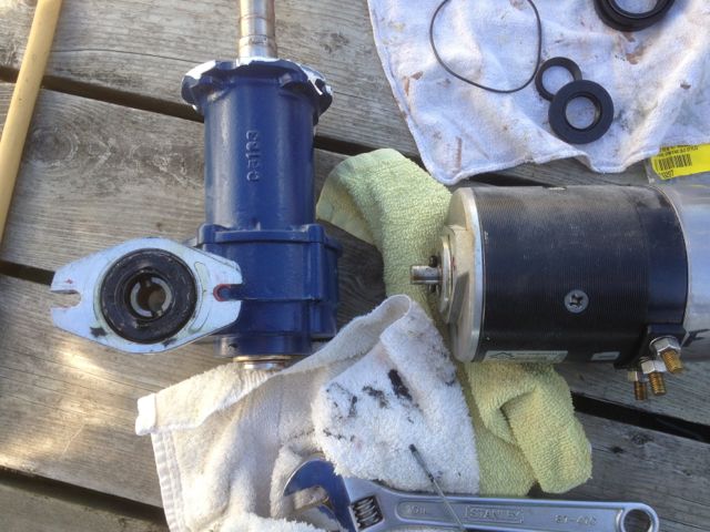

Oil has been dripping slowly from the cover under the windlass for a few years. Ordered 010207 Maxwell Windlass Replacement Seal Kit from Defender. Came with 4 seals, 2 orings and new site glass. Disassembled the Windlass from the top, as per the instructions above starting by removing the black cap, unscrewing the top bolt and lifting off all the parts on top in sequence. Then remove the two keys (square bits of metal on the shaft) and the black seal going around the shaft. See Photo 1. 4 bolts hold the motor & gear box (14mm). I undid them alone and the motor fell and dented the wood a bit so someone below would be helpful.
The seal that was leaking is shown in photo 2, partially removed. It was difficult to remove without scratching where the seal needs to go back in.
I should have removed the old oil by opening the site glass and draining it at this point after removing the old seal. I installed the new seal first which was a mistake as the oil was so thick it took me about an hour to drain and refill it via the site glass side. The oil has to pass over ball bearings which slows it down, but the bearings on the seal side are much larger and filling would be much faster on this side. The oil is the consistency of honey. The site glass side would only take a tea spoon size at a time and once the new seal is in it can't be removed without damage.
The motor alignment with the gearbox is not why it leaked on my boat. Turning the gear box by hand I saw play in the shaft of the gearbox and out as when the motor direction is reversed. The shaft on the gear box changes size right at the seal so as the shaft moves in and out the seal can't keep tight due to the shaft size change causing premature wear (this explains everyone having the same problem). The motor has a pin on its shaft so the motor & gear box alignment is not that important. Only used two seals from the kit.
Took about 2 hours. Hope this helps someone. Jan #303

- Photo 1. Top of the windlass. Black seal still in place and two keys on shaft.
- IMG_1084.jpg (48.12 KiB) Viewed 28245 times
- Photo 2. Motor and gearbox
- IMG_1080.jpg (63.86 KiB) Viewed 28245 times
- Photo 3. New seal installed.
- IMG_1082.jpg (49.86 KiB) Viewed 28245 times
