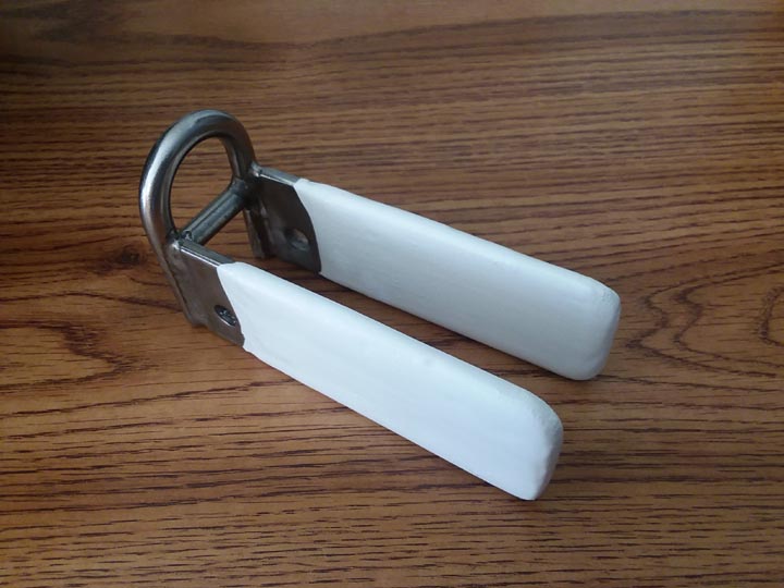

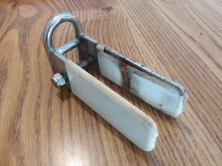

The rubber coating on our ladder latches has been deteriorating for some time, and I have wrestled with how to best repair it. Here are some before and after pictures:
Ladder Latch-Before.JPG (63.48 KiB) Viewed 7457 times
Ladder Latch-After.JPG (57.46 KiB) Viewed 7457 times
I thought about some sort of heat shrink, then decided to try Liquid Flex Seal. The pint can was the perfect size for dipping. The only issue I had is that I think the Flex Seal is probably too thick. Maybe good for a solid base coat, but it was so viscous, that it dried a little wrinkled and large 'dripping' places. I found that it was pretty easy to sand down to something close to smooth again, and applied a top coat by brushing on a mixture thinned with 2 parts Flex Seal and one part mineral spirits. I only did one side, just in case this process doesn't wear well or last long.

Gary,
Excellent-- thanks for the write-up.

The Admiral is considering brushing some of the thinned solution on cracked insulation on the life lines. Maybe I can get a royalty? :D
