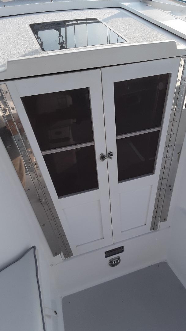

Re: Companionway Bug Screens
We made our companionway doors from Azac plastic construction wood. Used no see'em screen with removable plexi-glass panels.
We drilled 1/4'" SS threaded inserts into the hatch board channel and mount screens with SS hex head bolts.
"Seawing"
Hull# 309 2005
"Seawing"
Hull# 309 2005
