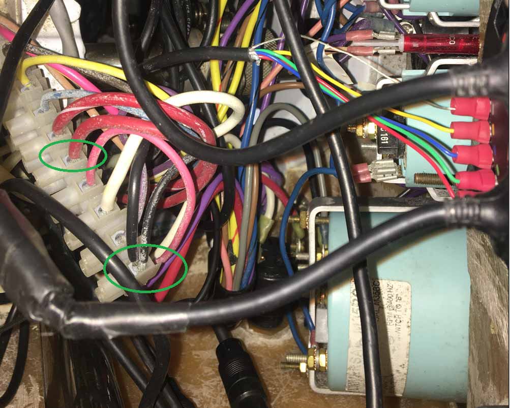

If you want to keep it simple the conductor feeding the "B" on the back of the key switch is hot when the battery switch below deck is turned on, there is a 20 amp breaker on the engine protecting the circuit (see engine wire diagram, highlighted wire harness going to pedestal). In my boat the engine wiring harness comes up through the pedestal and junctions with the engine panel via a plastic screw terminal block (see pic of terminal strip as viewed through compass access). You can tap into the power through the strip. Make sure you over-current (fuse) the conductor feeding your DC accessory with a amp rating for the accessory. Also don't forget the ground. The ground will also be part of the bundle coming up through the pedestal and should be black. Use a volt meter to confirm the Red "B" wire and the ground give 12 volts when only the battery switch is on.
While you have the pedestal open its a good time to inspect the screw terminal block where the wires connect with the engine harness. I found most of the conductors heavily corroded as they were exposed to the air in the block. Corroded wires or loose screw terminals can produce ghosts with electrical equipment. I ultimately replaced this terminal strip with a screw terminal strip from Blue Sea.
With all this said, this depends on turning the battery switch on each time you want to use the accessory. If you want it independent and controlled through the main DC panel you will need to run a separate fused conductor from the panel to the accessory. You can still ground the accessory through the main engine harness feeding the pedestal.

- Pedestal Wiring view.jpg (116.94 KiB) Viewed 9089 times
- M35B Engine wiring.jpg (141.27 KiB) Viewed 9089 times
