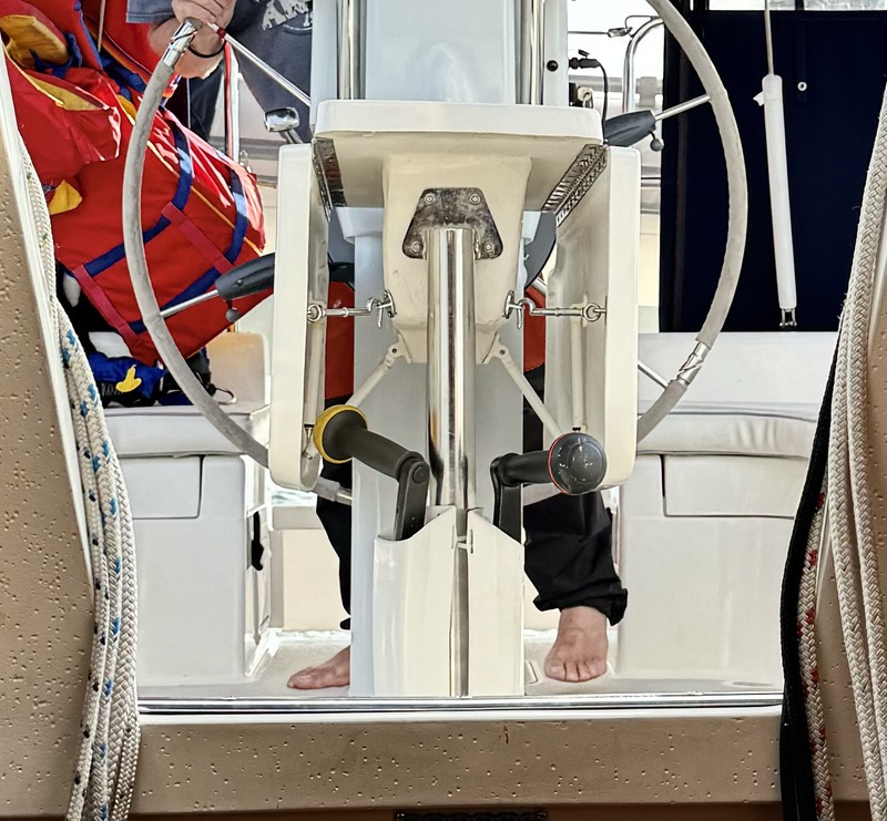

I finally mounted two holders to the base of the pedestal using strapping. No holes were drilled. The holders have slits in the sides at both the top and at the bottom to accomadate 1" strapping which I purchased at West Marine along with two SSteel "buckles". It's OK and has worked for a few races thus far. One holder is on the starbord side of the pedestal and the other on the port side. I place the winch handles in the holders with the handles facing forward so they are reachable from in front of the pedestal and they don't interfere with steering. I do not have a cockpit table. My crew "approved" this fix. Time will tell.

Finally we mounted both handle pocket a bottoms of table with the suggested method being 2-3 tie wrap around the table foot. So far 6-7 sails and work well as reasonably accessible from both stations (winch for Genoa and the pit.
