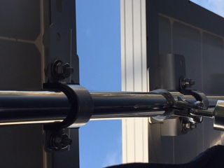

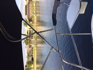

I bought 1 inch brackets to hold solar panels onto the one inch stainless tubing from McMasters. They are stainless and they have a hard rubber lining that clamps on nicely and no rattles. I had to brace the Bimini and the tubing. The tubes going across the Bimini are 11 feet long. I have a half inch droop in the middle. It could be because of the span or the ends are too high. This was like putting an erector set together. Fortunately my neighbor is very patient. I still have tweaks and a plan to fix the half inch droop. However, the cost for the tubing and parts was very little compared to buying an arch or hiring someone to do it.
Let me see if I can post some pictures. Also, I decided to go with four panels. I could have easily gone with two and put them on my davits and that would have been much neater.
I used about 35 feet of tubing. I paid $5.50 a foot for 304 stainless tubing. The tubing ran me about $200; the clamps, jaw slides, slide ons, end caps and screws/bolts/ nuts about $300; and solar panels, meter and Mppt controller $850. Labor was free. It took two seven hour days. It took two three hour days of measuring and planning. I have a little more reinforcing to do. It was a fun project and learning experience. I also solared up my caribe rib.

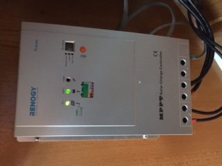

- MPPT controller

- McMasters brackets holding panel to stainless

- Bimini Reinforcement
