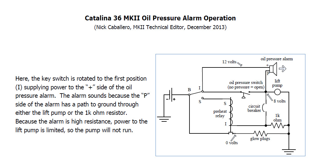

Here is another diagram which is easier to understand from another catalina site.
- Buzzer.jpg (81.83 KiB) Viewed 42181 times
- Posts: 466
Re: Engine Alarm / Buzzer
For all you electrical experts out there, What creates the supposedly 8 V shown in the diagram I found below on the Catalina 36 web site?
I measure about 9.5 to 10 V at that point on our boat. I thought the 8V was likely created by the 1K resistor circuit to ground, but when I disconnected that wire, I still measured 9.5V on the wire terminal lug. Is it coming from resistance in the buzzer, or from the ground path through the fuel lift pump. If it is from the path through the fuel lift pump, is that the reason the alarm is erratic, as the fuel pump could be in a variety of positions when you turn the engine off resulting in different resistances to ground and thus varying voltages seen by the alarm buzzer?
Our buzzer, like most of the others have noted, is very erratic. Sometimes it does not work at all, sometimes it is weak, and sometimes it is stronger. Never seems to be loud and 'alarming', but at least the Admiral can usually hear it.

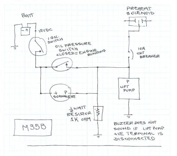

I appreciate this is a very old thread but I wonder how many people are confusing their intermittent buzzer with the fact the low oil pressure switch alarm is actually a pulsating tone? There are three connections to an alarm buzzer: + which is of course 12v power, then a P terminal and a C terminal. The C terminal is connected to the water temp switch and is normally open. Thus there is no ground, when the water temp, hits about 100c (approx) a continuous (hence the C terminal) tone is heard.
In contrast the P terminal (P for pulsating) is connected to the oil pressure switch. If the tone is activated when your engine is running it means oil pressure has dropped and the switch has opened causing the power to the lift pump to be lost and with the key in the “i” position 12v will still be fed to the buzzer + meaning an alarm.
To test your alarm buzzer, simply open the engine panel on the pedestal. Check for a good battery voltage at the + terminal of the buzzer (turn the ignition switch to i with the key switch or connect a 12v battery). If good, disconnect both the C and P terminals and connect them to a good ground - one at a time. The C terminal should buzz loudly and continuously (and light up the warning light if it is still connected).
The P terminal should buzz with a pulsing tone and light up the warning light if connected.
At the moment only my C terminal emits a tone, so I have to buy a new buzzer to get the Pulse tone working.

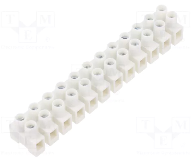

This is probably a long shot but one other thing to check is the terminal block behind the faceplate on the pedestal. I had issues with the buzzer emitting a faint, intermittent chirp from time to time. A couple of month ago I replace my faceplate which necessitated removing all the electrical connections. Afterwards I couldn't get the buzzer to consistently work. After many dead ends I traced it to a poor connection on the terminal block. I can't remember which wire was the culprit but started by tightening all the screws on both the input and output sides of the terminal block. Problem solved.
Be sure each wire is fully seated into the block and tighten each screw firmly. Here's what the terminal block looks like if you're not familiar -
