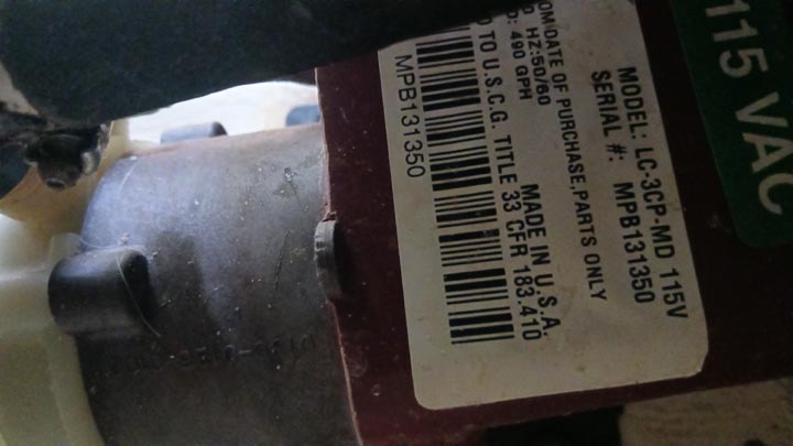

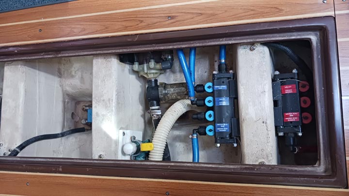

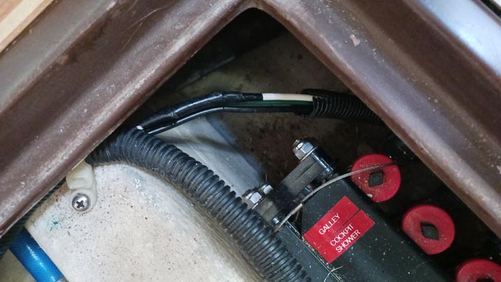

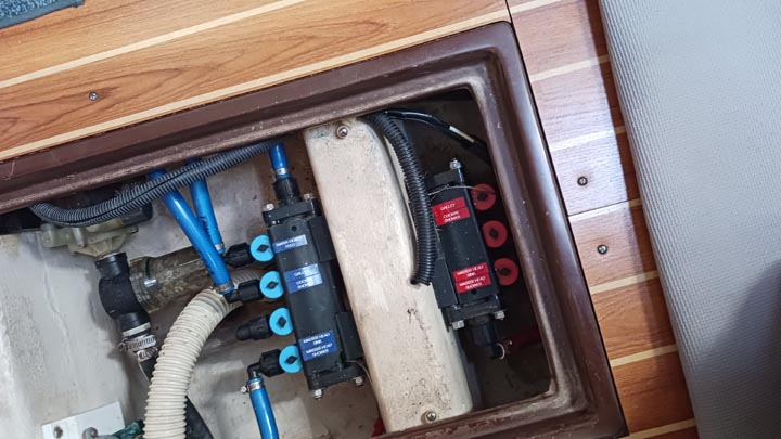

Update 2025:
I replaced our original CAL pump on our 2007 C350 in 2013 with the March LC-3CP-MD. The mounitng was different, but not difficult. The wiring for the March pump is encapsulated meaning there is little chance of a poor connection in a salt water environment. I simply spliced the pump cable going to the AC unit near the hot water manifold above one of the stringers so that the splice connection would not be exposed to any water in the bilge.
The original CAL pump lasted 6 years. The March pump has run almost continuously in the hot Florida sun for over 12 years.
Here are some pictures of the installation.
