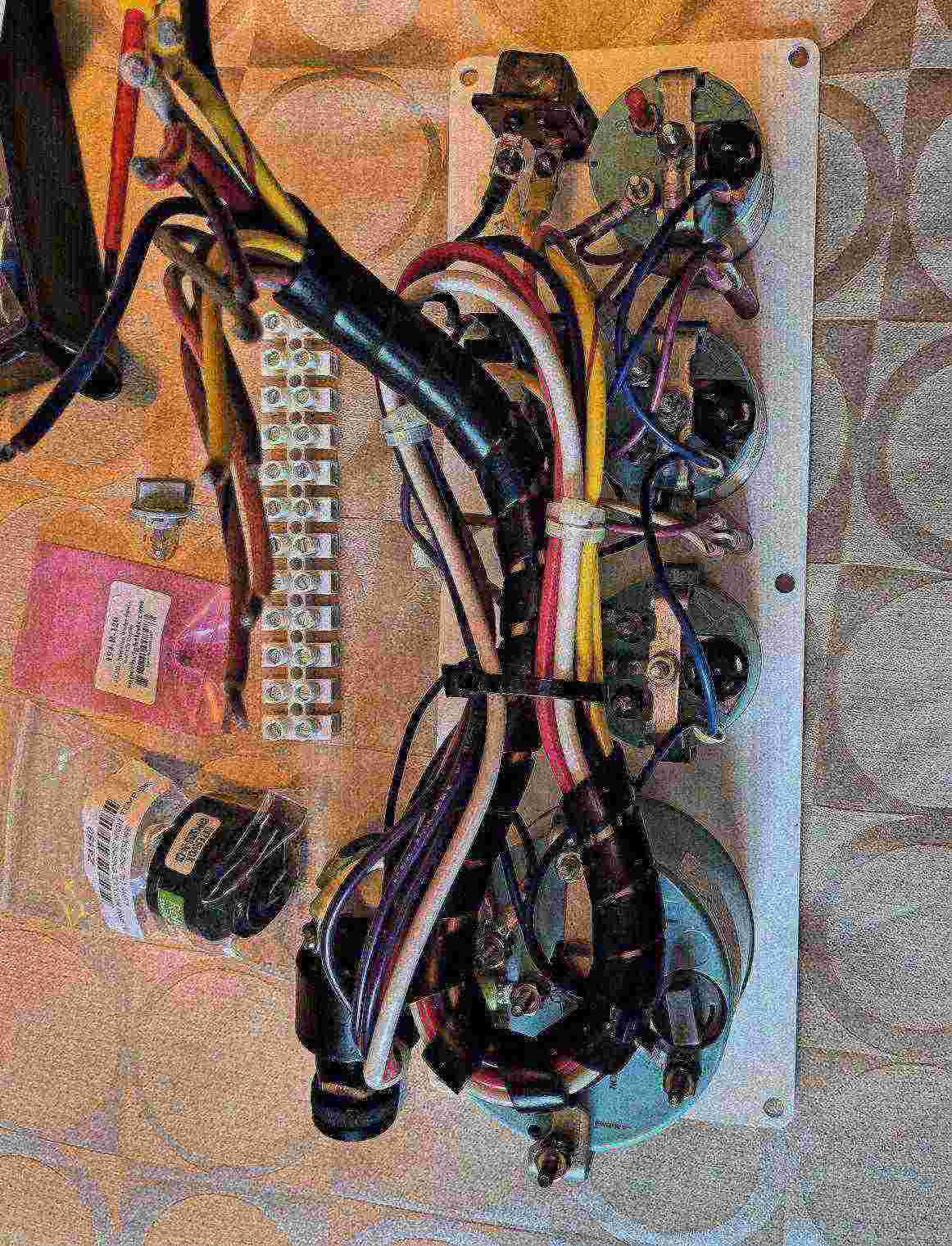

Checked the inlet strainer, changed the oil, changed the thermostat, changed the impeller and fitted a new buzzer and cleaned all the connections and also changed the horrible connector strip ($12 at Catalina Direct, they also stock the buzzer). At the same time I changed the worn engine panel (new enameled metal plate bought from someone who made replacements on this forum), the whole job was very time consuming, maybe 10 hours.
