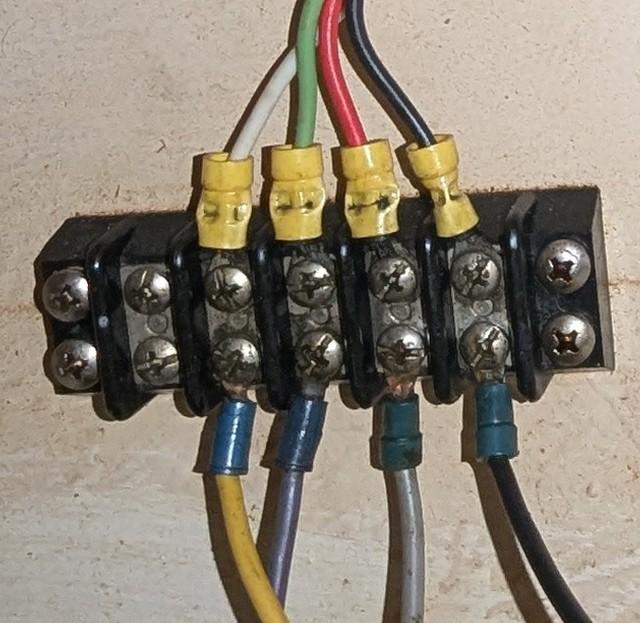

Hi. IDIOT here. I was going to clean the contacts on the terminal block beneath the head's sink. However, like an idiot, I didn't take a photo of the wires and their locations. I only removed two of them but now while the deck light works fine, the steaming doesn't. I tried to install the festoon bulb in it and there was a flash and then nothing. Here is a photo of what I have currently. I SWEAR that one of the wires was supposed to be connected to another one but don't remember. Any help would be more than appreciated. Thanks dave "the idiot"

Re: Circuit Breakers
Hi nybor,
I'll be back on my boat not this w/e, but the next.
I'll compare what's in your photo to what's on my boat.
BTW, you mentioned that you changed the bulb, got a flash and died.
That's pretty indicative of a dead short somewhere...

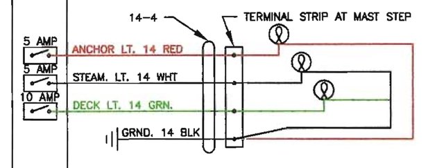

Dave, here's the schematic from the manual. Unfortunately it looks like the color coding on the mast side of the terminal block doesn't match what you have.
