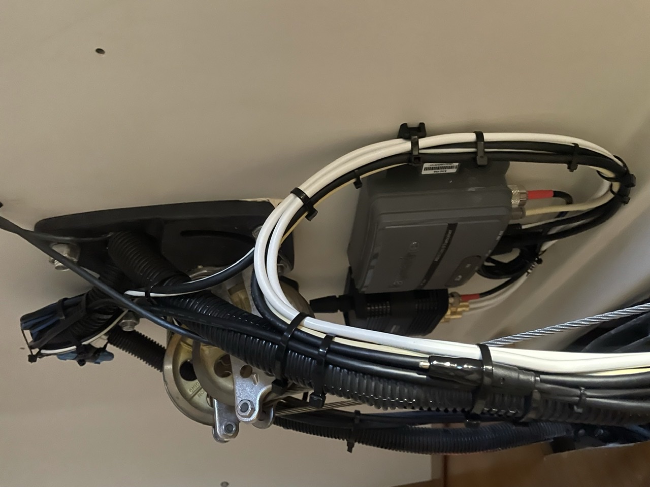

SeaBreeze78
Posts: 41
Joined: Sun Aug 09, 2020 12:20 pm
Re: AIS addition
Post by SeaBreeze78 »
Greetings:
I just had a used AIS installed in my boat. GPS receiver is mounted on port dinghy davit with a clamp type base. Line runs through a “clam shell cover” into the interior of the boat. The two black boxes are attached to the ceiling in the aft cabin just forward of the aft bulkhead. After removing the fiberglass cover over the steering cables. You will find plenty of room for the VHF splitter and the AIS box. I thank Bill Cullen for pointing out this great place to hide the boxes out of sight. ( Looking to starboard, Bow is to the left, stern is to the right )
