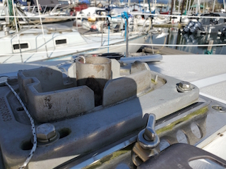

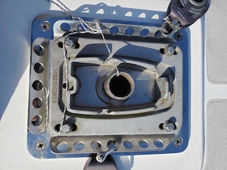

Can someone please post a picture of the mast step and wiring conduit?
Lagniappe, Hull #385
- Posts: 72
Re: Mast Removal
Hopefully this helps.
- Deck step 2.jpeg (48.02 KiB) Viewed 24755 times
- Deck step 1.jpeg (82.55 KiB) Viewed 24755 times

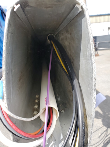

- Posts: 72
Re: Mast Removal
This might help as well. This is all new wiring. On the left is the 1" conduit to the mast head. Orange and Grey are stock colors for the anchor light,
Red is a redundancy wire in case we ever wanted anchor and nav lights up there, additional pull string, black is the new Garmen Gwind and larger white is the new RG 8X coax for the 5215 Shakespeare AIS / VHF antenna.
Had this conduit terminated about 3" higher up the mast pulling down from the top would be possible. As it is this conduit terminates pretty much parallel to the top of the pedestal conduit stub. On the right is the 3/4" conduit to the steaming / deck light / radar. Purple, yellow and black are the stock colors for the lights, the two larger Blacks are new radar.
- Mast base.jpeg (117.12 KiB) Viewed 24754 times
Re: Mast Removal
Bob,
Thanks for the pictures and descriptions.

- Posts: 149
Re: Mast Removal
Hi Bob
Was just going over your submission from April 1.
You mention the position of the large conduit being parallel to the stub in the deck step plate. Can you clarity for me, were you saying that it would not be possible to pull cables down from the top of the mast because the location of the stub relative to this conduit? But it would be possible if the conduit ended a few inches higher. Are you suggesting that setup would allow the cables to more easily pass thru the stub?
I'm having a rigger go up the mast to mount a new wind sensor and he suggests they could try to use an existing cable and attach it to the new wind cable to pull it down and through. But he won't guarantee that it will pass through the deck step and they can only try.
I've had other input that getting a cable out the bottom of the compression post is the hardest part because of the 90 deg elbow under the post.
Still hoping to avoid pulling the mast. Your pictures are a big help to visualize things.
- Posts: 72
Re: Mast Removal
Hi Kirk,
Sorry I did not see this sooner.
Yes on closer examination I think it will be iffy but worth a try. Had Catalina removed 3 or 4 inches off the bottom of the 1" conduit to the mast head, this mast in place cable fishing would work. The 90 degree turn at the very bottom is nothing. If you get past the deck step that wont be problem.
Often the wires are taped together which would make a single wire more difficult if used as a leader. Because the cable for the wind transducer is relatively thin it may well make it past this conduit to stub abrupt turn. Lube it up well.
Personally I would choose either the orange or grey anchor light wire, detach from the terminal block in the head, cut off the connector (important) and tie and tape 2 thin halyard leader lines to the wire and pull the wire up. Feed from the bottom as best you can until the connection starts up the pedestal conduit which you can just touch from under the sink. Pulling down is giving you another 90 which is just more friction. If successful in getting this up and out, tie off one of the lines, re connect one line to the lamp 14AWG and pull the wire down by itself. The use the second leader line to pull the wind instrument transducer cable down. I would not do these together. Even safer would be to pull up a new anchor light wire using the existing one. Again with an additional leader line beside it. At least this way you would have the anchor light wire back plus a leader line to pull down the new cable. There is one more thing that is done by pro riggers. You could cut (hole saw) an opening in the side of the mast at the bottom so that a) you can pull the cable(s) out the hole and work through this to catch the upper cable and a fish tape from the lower or b) install a deck gland and bypass the pedestal. Many boats are stock like this. With a bit of effort this could be very invisible below deck.
Fortunately I had so much more to do in the mast that pulling it was mandatory and I didn't have to consider the above.
Best of luck.
