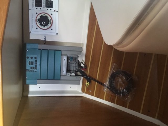

Ok, so no inverter/chargers installed from forum users, or at least in the existing position.
I pretty much researched everything available as an inverter/charger with internal transfer switching that I could find on the internet and there is nothing that fits in the space that the Charles 5000 currently resides in. The limitation is that 12" height and approx 13" max width. I looked at even moving the switch panel of battery bank switch and the engine on/off switch but the opening behind and weight of cabling made it impractical. Hence I looked at just a charger replacement for now and even that is fairly limited in choice. Xantrex suck the air in at the top and blow it out the bottom and that would mean mounting horizontally to meet the 4" clearance they require. Many others were also constrained by airflow if not from a simple size/fit standpoint.
For the charger replacement I went with a Mastervolt 35A unit with temp sensor and three stages plus equalization mode it fits after enlarging the opening for cable access underneath a little and it fits vertically with just enough room to drop onto its mounting bracket. It sucks air in through the sides and out the bottom.
Trying to find an inverter that would include a transfer switch that fits in the space remaining under the switch panel (best position for DC cable path/length) is also a challenge. I want to have sufficient to run the 700W Samsung microwave via powering all the starboard outlets from the main panel, but haven't seen anything yet that fits the space remaining.
