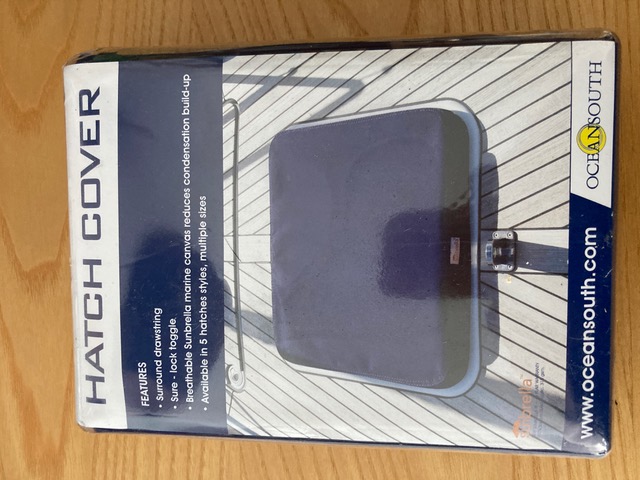

The forward hatch is absolutely the trapezoidal one, thought I had the original code but can't find it. If you get a new one, worth buying one of attached, hatch will then outlast you by a long way.
Russ
Russ
- cover.jpg (98.33 KiB) Viewed 13419 times

Thanks Russ
Did you do the lens replacement? If so how did it go for you. The cover is a great idea.

My lens was just slightly crazed and not too damaged so I polished it up to "reasonable" and put this cover on, is is holding up well so I haven't considered replacing either the whole hatch or just the lens.
