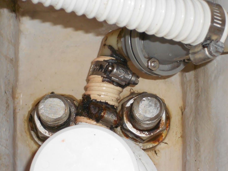

As you have seen, there are mixed reviews on bilge pump check valves. The argument for them is to prevent exactly what you are seeing, the bilge pump cannot completely clear the discharge line (too high a lift for the size of the Rule pump) so a check valve will prevent the remaining water from draining back into the bilge. The argument against is that if the check valve fails (becomes clogged, fails to open) the bilge pump will run but no water will be pumped out- that happened to us this season. I only have the one Rule bilge pump so for me there isn't enough water left in the discharge line to trigger the float switch (which is in the center bilge section). I suspect in your case the flow back is sufficient to trigger the first pump in line as it has an internal automatic switch.
I've attached a picture of how the setup looked when we took over the boat. You can see the gray check valve. I have replaced all the hoses and hose clamps (so please ignore the nasty, rusty ones in the picture!) and initially replaced the check valve (from West Marine). After the valve failed this Spring, I took it out. So far that has not been a problem. Our pump rarely runs - usually only when I intentionally drain the water tanks or fill the bilge to check the pump- the flow back is not enough to trigger the float switch. I do get rain water (likely from forward) but it's not been enough to trigger the pump.

Pete and Anita,
Thank you for your reply. I would love for my bilge to look like yours - even with the rusted clamps!
I actually purchased a bosworth check valve - it looks similar to the one in the photo, but was in doubt whether and where to install. I was thinking that the check valve would need to be installed close to the pump to insure there is enough pressure to push the water through the valve. So this weekend I want to try installing the check valve close to the "nuisance" pump (smaller primary) like in your picture and then leave the secondary larger rule 2000 pump ( with the float switch at the higher level) without a check valve.
To be transparent - when I bought the boat there was a jabsco check valve on the secondary discharge line about 8 inches away from the pump - but there were multiple connections and multiple hose sizes that did not fit and were leaking and the water was not passing through the check valve. I removed the check valve and replaced the hoses. There was no check valve on the primary/nuisance pump. My fear would be that the primary pump would operate and push water back into the secondary (because they seem to be the same discharge line).
I guess I need to try it out and see what happens.

Pete and Anita,
One more follow-up - when you say you replaced all hoses - did you replace the entire discharge line to the rear of the boat? i.e., did you unscrew and lift up the floor boards around the bilge in the salaon? I was contemplating this to check out the hoses and also to see if I can get some direction on the leaks, but this looks like one large awkward piece of flooring (with los of screws - including a few rusty ones), I guess I should know what is under there regardless.
You have a much higher hull number than mine so maybe the flooring is different i a newer year model.

Norm: To answer your question about what we replaced. I did not replace the entire discharge line, just from the discharge line to the bilge pump. I am not entirely happy with the type of flexible hose but it is what I was able to fit into the space. I did need to use an adapter to marry it up with the discharge hose.
I believe the majority of the water we get in the bilge does come from forward. After heavy rains we get water in the small compartment just aft of the v-berth (access to the speed log through hull) and am sure it then flows through to the bilge. We've resealed the access cover forward but I am not convinced it is totally sealed. It is rarely much water unless heavy rains for several days.

My bilge hoses have a similar set up. Flexible hose into the discharge line. But I have the two pumps. Will share pics of my set up after I solve the backflow (this weekend
