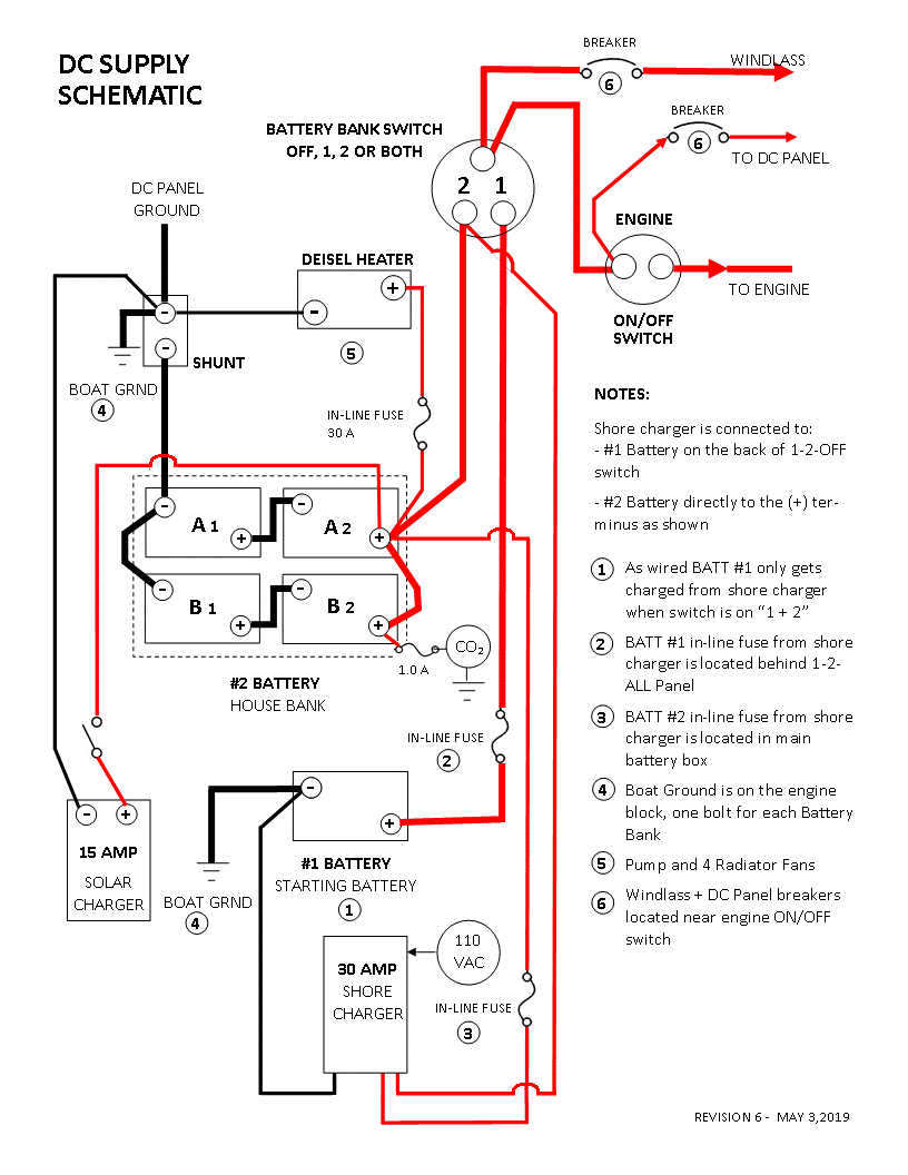

I have a similar setup to others, with the house bank paralleled (4 golf carts - 450aHr) and a separate "no" maintenance Group 27 starter battery. I normally stay on the house bank and use the starter battery occasionally to make sure it actually works (it always does).
Since I have the optional 3rd water tank under the port settee, there was no room for the Group 27 there but it fits very nicely located aft of the engine under the berth. The Victron battery monitor is a key piece for us as is the solar charging system I installed 2 seasons ago. With these additions I'm on top of the DC system and find the solar panels keep the batteries well charged. We cruise for up to 8 weeks at a time and rarely need to charge with shore power or with the engine.
I agree with input from Scott on tracing wires, its key to help in understanding the boats systems. Documenting your findings means you don't need to rely on your memory.
After buying Sand Dollar 3 years ago I needed to know what the PO had done with the various systems to understand what I would need/want to change. I went through all the systems on the boat and documented them in the form of schematic drawings. I did the DC wiring schematic first which I have attached here. I keep it updated as I make upgrades/changes etc. Also did a plumbing drawing for the Hydronic heating system (its needed in the Pacific NW for any shoulder season cruising).

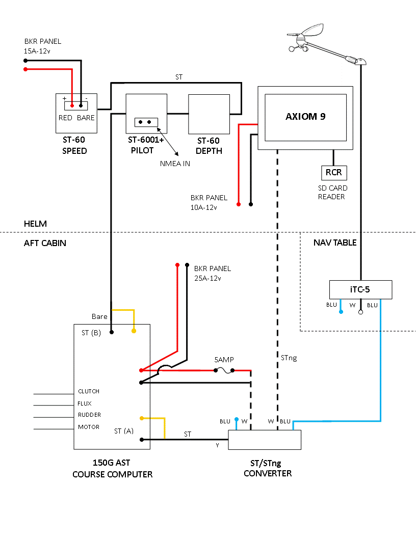

Most recently I did the navigation instrument schematic which includes the network backbone I installed in order to upgrade the chart plotter and other instruments to meet the NMEA 2000 (Seatalk-ng) requirements of the newer instruments. Some work on this is still in progress/pending so I can refer to the drawings as I tackle new projects. Drawing is attached here.

- DC SUPPLY SCHEMATIC.gif (44.31 KiB) Viewed 32531 times

NIce drawings! What program are you using for that?

Kirk,
Yes, very nice drawing.
A minor suggestion:
On your four 6 VDC main battery bank, have the house positive and negative come off different pairs so electrons flow equally through both battery pairs.
So, either positive from A2, negative from B1 OR positive from B2, negative from A1.
I also agree that any new buyer should not ASSUME how a previous owner wired their boat, but to VERIFY so they know how to maximize 12 VDC performance.
A minor suggestion:

My wife produces the drawings from my hand sketches, she a retired drafter. With no access now to the high-end CAD software, she used Microsoft Publisher to do these drawings.
Thanks for the input, I've heard/read somewhere about wiring them that way. Its on my list now.
