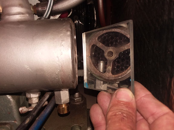

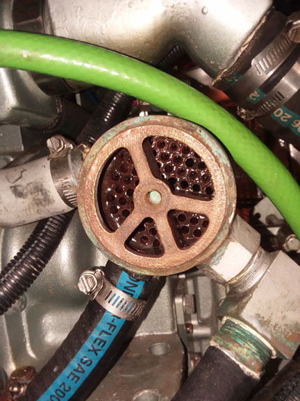

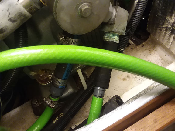

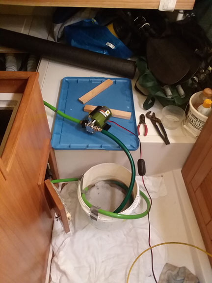

Just finished testing results of the HE flush process I completed last week. Engine temperature at cruising speed dropped by about 10 degrees from where it was. Previously engine was running around 165 at 2,000 RPM and climbed close to 180 at 2400 RPM. After flushing temperature remained the same around 165 even at RPM up to 2600 for about 15 minutes trying to make a bridge opening.
I wound up buying a 12V transfer pump from Harbor Freight for $45. The pump came with a pick up screen and inlet hose. I removed the raw water inlet and outlet hoses on the HE and connected a short piece of the standard 3/4" and 7/8" hoses to the HE. Then reduced those hose connections to a section of 1/2" garden hose connected to the pump. The pump intake hose was placed in a small bucket containing Barnacle Buster (I used plain water to test setup for leaks before flushing). The outlet from the pump was connected to the HE inlet, and the HE outlet discharged back into the bucket. I let the pump recirculate for a little more than an hour. This is the inside of the HE after flushing: The other end of the HE with a new zinc installed: Note that all HEs are not necessarily the same. Notice that the zinc location on my HE is off center allowing for a full length pencil zinc without any modifications. Now I also have a 12V emergency backup bilge pump in case I ever need it. It just clips on to the battery terminals and is rated at 290 GPH

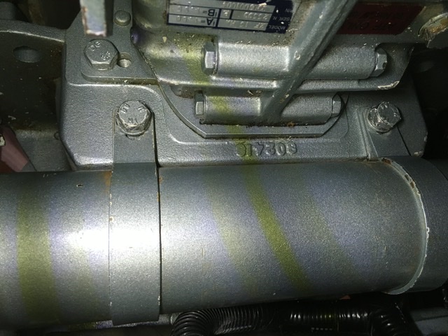

Just reinstalled my heat exchanger after removing it to soak in vinegar and check the zinc clearance. Remounting the exchanger was a bit of a challenge due to the lack of sight lines, the spring like nature of the bracket and the transmission fins blocking a straight line to the bolt. Found that accessing the engine from the top was too tight and allowed no line of sight. So, pulled up the aft berth mattress and board over the prop and exhaust. This allowed dA clear line of sight and more room for tools and arms. See photo of transmission fins interfering with direct alignment of tool on the bolts.
Refilling the anti freeze was easy by opening the butterfly valves at the water heater, thermostat and heat exchanger and closing them as they weep antifreeze, with no air locks.
