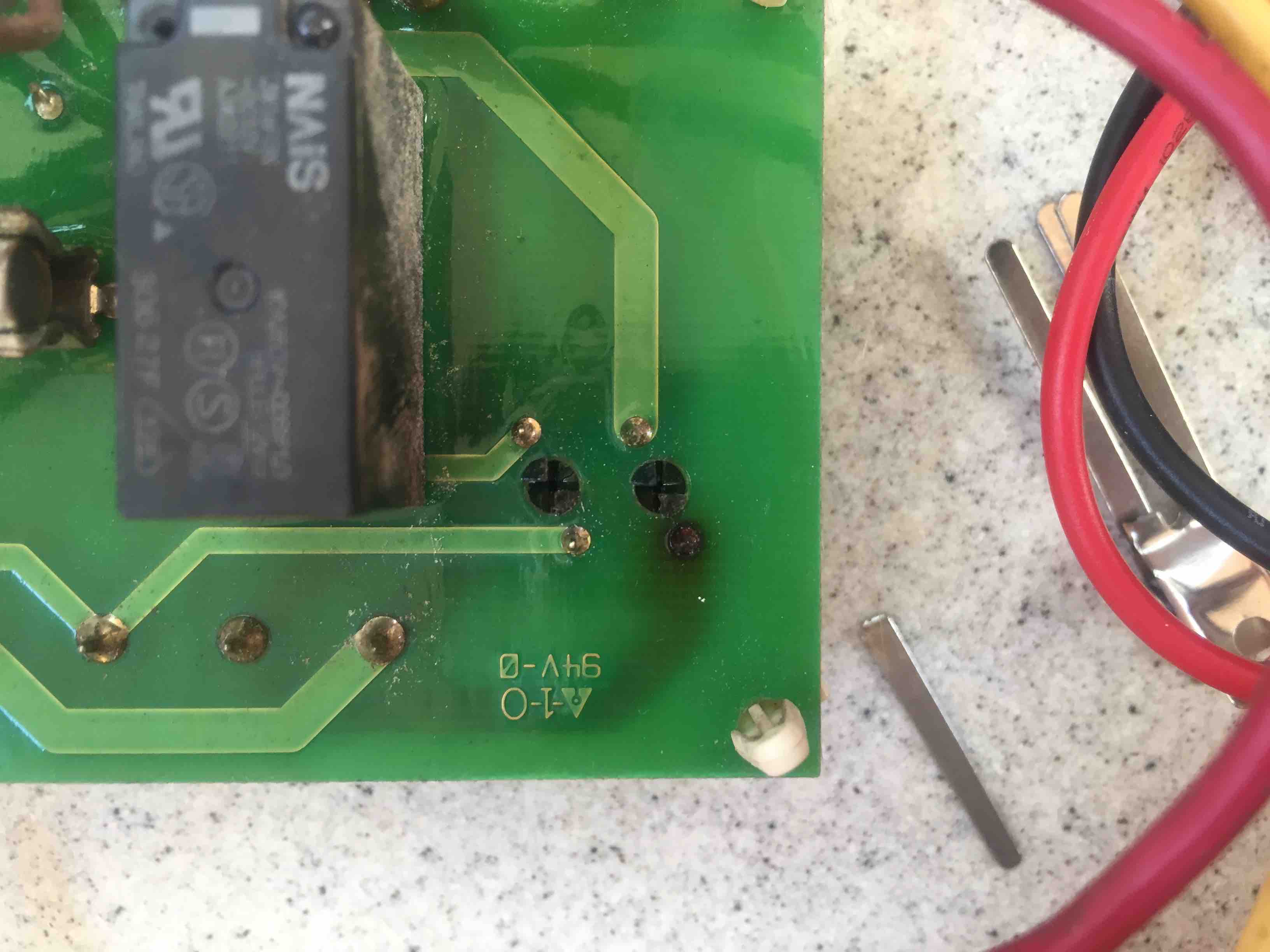

I tried to scratch/clean the fuse contacts as best I could before installing the new fuse. I can hear a faint hum like the compressor is trying to run but nothing else. The LED isn’t lit and the spillover fan runs.
I pulled the module out to see what the circuit board looked like. There was some discoloration near one of the solder joints from the 15 amp fuse.
PC board.jpg (214.01 KiB) Viewed 26984 times
This unit is 14 years old and a bit of Googling didn't show any hits for this board.
The back of the PC board says:
Waeco Adler Barbour
Cold Machine Board
F - 1886 Rev 2

Unfortunately that printed circuit board is poorly designed structurally the power copper strip plus and minus will overheat and burn through.
Check TECH TIP # 1 on my web site for more info. http://www.kollmann-marine.com/tip1.aspx

There was a rumor that AB had developed a replacement board correcting the CU 100 and CU 200 failures. It would be a mistake to replace with the original failed design.
You can bypass the complete board and be sure to add a new 15 amp fuse to the refrigerator boat's power wire. By bypassing it you lose the 5 amp fuse circuit that might be powering any additional fans loads and the trouble LED. If this is a CU 200 water cooled function is also lost.
Best solution is to leave this circuit board in place and remove 15amp fuse. Then connect a jumper to existing power wire terminal and other end of jumper wire along with existing power wire on Danfoss module. Do not forget the refrigeration now must have a new in line 15 amp fuse for protection.
The last jumper wire required is needed to again go around circuit boards ground terminals keeping original wires connected as well.

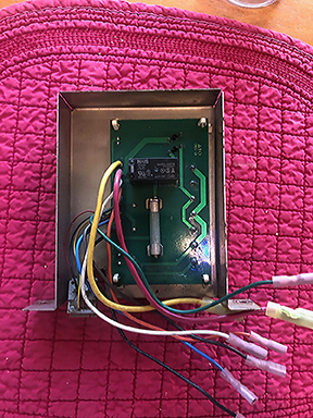

I'm back up and running after replacing my circuit board (thanks again Peter). Another strange anomaly associated with this project was the wiring from the board to the compressor controller. There are 8 color coded wires that run between the 2 components. I took a picture before removing the old board. After quadruple checking the connections from the new board the unit still wouldn't run however the red LED was lit but not flashing. No mention of this in the manual so I called Waeco. They immediately said I have something wired wrong. Everything still agreed with my picture so in desperation I pulled out the manual and noticed 2 wires were in different positions. After switching them the unit powered up. Go figure. I'm the original owner and have never touched those wires before and the unit has run fine for 14 yrs.
My previous problems with fuses on the circuit board always involved the 15 amp one. This printed circuit board is there largely for diagnostic purposes. If your unit quits cooling, the first step is to look at the LED and see if it's lit and note the flashing pattern. The codes are listed in the manual and will being to give you an idea of where your problem might be.
