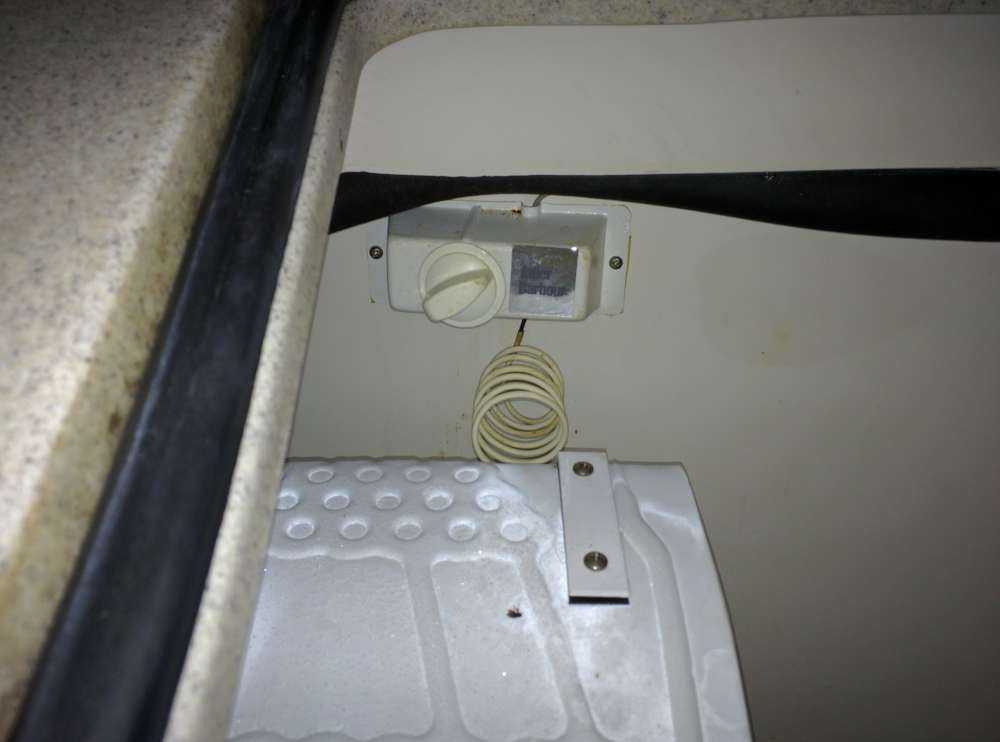

Hi guys,
Just got to boat 2 days now. Turned fridge on just one click. There are not any numbers on the knob so not sure where to point it. I just moved it off the click.
It froze water bottles on the spill over side. Can someone tell me where I should be putting the knob or any other hint on this.
The Fridge does seem to run a long time.
I did search the archives and not seeing anything.
Thanks.

Verify that the coil of "wire" shown in your picture is attached to that plate screwed to the top of the chill box.
That "wire" is the thermometer, that provides feedback to the control unit on how long the refer should run.
If yours is connected, it certainly isn't connected the way mine is (which is visibly connected by being held down by that plate to the top of the chill box) ...if it's not connected the Adler Barbour unit will run an awful lot longer than if it is connected.

The Coil seems to be attached properly. It is secure at the white plate on at freezer. It just seems to never stop running.
I'll try pointing the knob down and see if anything changes. It seems to freeze the bottles right off.. the off stop.

If the wire is connected to the cold box I guess that's fine, it's clearly connected differently than mine is which is connected under the white metal plate visible at the top of the cool box in your picture.
The direction of the knob pointing is really not standard...it's just a rheostat...one way (counter clockwise) is less cool... one way (clockwise) is more cool...Ours wouldn't get cool enough so I took the rheostat apart and adjusted it so it would get colder...then re installed it...if its too cold for you just turn it counter clockwise.
This was a point of discussion about 10 years ago, when some people were more concerned about condensation, than about cooling...some people including the very knowledgeable tech rep at the time, felt it was better to have a hot freezer that didn't cause condensation on the counter top, than to have the freezer actually maintain a frozen environment.
To each his own...again, it's just a rheostat...adjust it to whatever setting your good with. And I'm not sure what the problem is with freezing water bottles??? Are they freezing in the freezer or in the refer??? There's a separate rheostat for the cross over fan to the refer...if your freezing things in the freezer...isn't that the point?...If your freezing things in the refer, turn the separate setting in the refer down, that will shut off the cross over fan.

All makes sense... I do have a Spillover no Fan.
I did get it to stop running. Counterclockwise right up against the Off stop. Confirmed by Amp Meter. Stayed off about 3 minutes and back on. Looks like it is working. Probably need to think about insulation.
