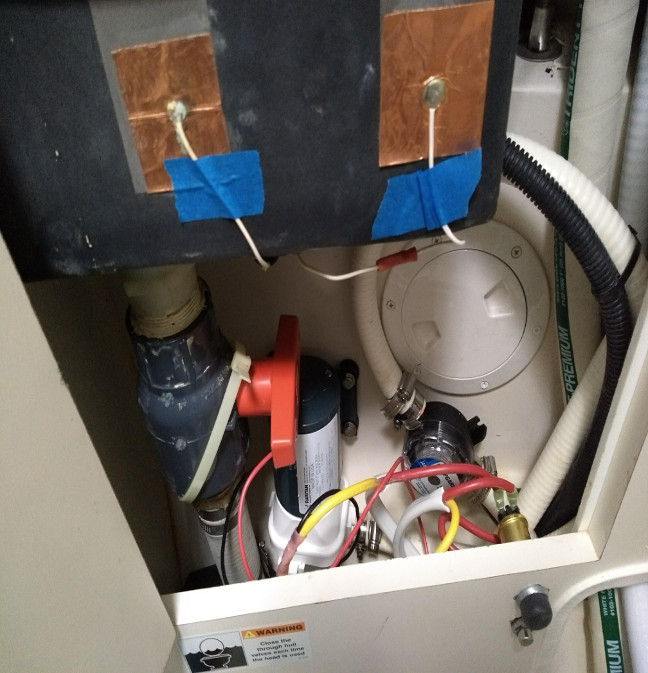

I replaced ours (Wilcox Crittenden) with the Sea Era about a year ago. I got the kit without the bowl and reused the porcelain bowl from the previous head. I also got the unit that has a separate sea water pump motor. I mounted that sea water motor in the closet behind the head and wired to 2 flush buttons, so if you press the main flush button you get a wet flush. If you press both buttons, the second button interrupts power to the sea water pump and you get a dry flush. Good for conserving tank space, or for times you want to use the shower water for flushing.
The sea era fits fine as is. Get rid of the silly pedestal / spacer from the previous head. I just ran 1" waste hose all the way up to the tank. New head works great and is way quieter than the wilcox crittenden that it replaced.
Pics attached. You can see the separate sea water pump near the overboard discharge valve in the second pic.
