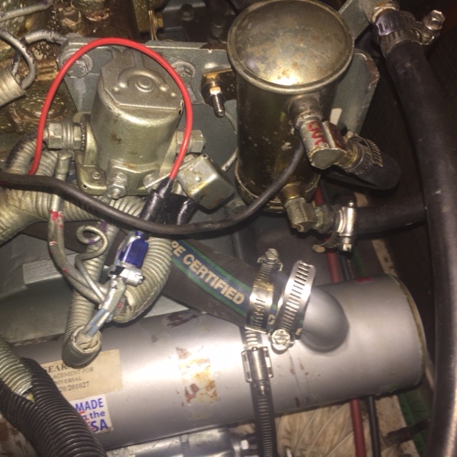

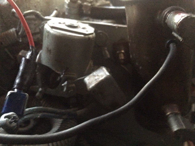

Thanks for all your replies and messages. Had the Admiral turn the key while I listened and I heard nothing. So, I am going to try NAPA for a pump and if they don't have one I am going to order one online from Aircraft Supply.
I am also going to try to figure out how to electrify the fuel lift pump without turning they key since I am frequently on the boat myself. (I used to have a 1982 Catalina 27 with an 11hp diesel that I bought new that I could bleed the fuel from down below. That was pretty useful.)
I forgot to post the picture so I am trying again.

Thanks for all your help. The hopefully final outcome. I had a bad wire leading to the fuel lift pump. The wire looked fine, but somehow it must have been broken under the insulation. Someone had spliced in a red wire for some reason. After cutting out That wire and putting on a new connector I got a strong chatter sound from the pump. We had to bleed the air out even though it is supposed to be self priming.
I had bought a preheat Solenoid, 10 amp circuit breaker, resister and low oil pressure switch. I had also bought a pump from aircraft supply for about $80.00. That pump did not come with the elbows for connecting to the 5/16" internal diameter fuel lines. The aircraft supply pump comes filed with what smells like mineral oil. So I went to NAPA and bought the elbows for about $4.00. The original pump and all other parts Are working so I have a bunch of spares.
FYI Only and thanks
