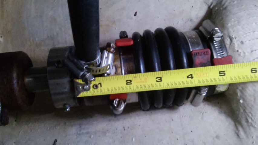

Very helpful post. This is probably be the major source of my bilge water problem. It doesn't always leak, but it has been a pronounced problem this year. I was able to use a prybar and move the collar about 1/2" away from he transmission and retighten the screws. It was resting on the transmission flange. This total dimension should be 6 1/4"? I need to compress this another 1/2 inch?

Wind Seeker, the correct length for the compressed bellows is 6 1/4". From the picture you attached, it appears that the aft end of your bellows only has 1 hose clamp. There should be 2 clamps on the shaft log and 2 on the carbon flange. You're probably aware but there are 4 set screws securing the stainless rotor. They are stacked in pairs on top of each other. It's important to completely remove the top ones, slightly loosen the inner ones and then compress the bellows. PYI recommends replacing the set screws when adjusting the bellows as they make a small dimple in the shaft when tightened.

Pete, I'm not sure why your seal is leaking with that much compression. The set screws that hold the SS collar in place sit below the surface of the collar on my boat. I assume you are aware that there are 4 screws in the collar and consist of 2 pairs of screws stacked on top of each other. The outermost one must be completely removed from the collar in order to access and tighten the one that contacts the shaft. You can replace the set screws with the boat in the water by making sure that there is a little tension on one pair of screws to keep the bellows in position. Replace the other pair. Once they are tight you can replace the remaining pair.
I'd give PYI a call regarding the fact that you still have a leak in spite of the over compressed bellows. Any chance the bellows itself is cracked and leaking? If so you could have a potential disaster looming.
Keep us posted on what you find out.
