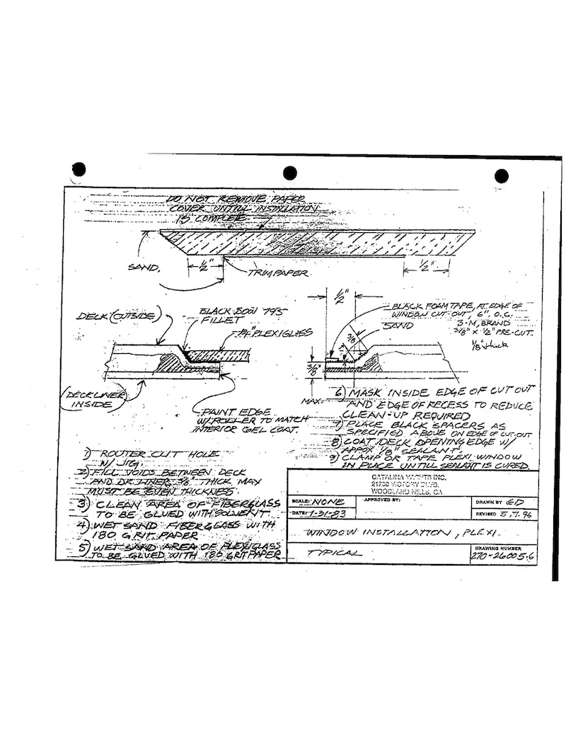

Hi Al,
I've never had to deal with leaks or replacing fixed ports (yet
) but I've attached some instructions from Catalina regarding replacing. I don't think they are "model specific". Sorry they're not the best quality.
- windowinstscan-2.jpg (171.6 KiB) Viewed 10592 times
- windowinstscan-1.jpg (151.91 KiB) Viewed 10592 times

Only thing now that confuses me is the text v.s. the image.
In the image, it shows a 3/8 wide strip of butyl rubber foam tape ( right side of picture ) and that tape is nowhere else described.
Left side of the image is just what the textual instructions say to do.
Any ideas?
Al

Re: Q about the non-opening "windows" , replacement and proc
Al, I'm not sure but I think the butyl tape just acts as a spacer to maintain a uniform thickness and avoid all the 795 from squeeezing out. It looks like it is placed every 6". Here's a link to the C34 web site http://www.c34.org/wiki/index.php?title ... ght_Repair regarding the repair which might shed a bit more light on the subject. I agree that the diagram is a bit confusing.
