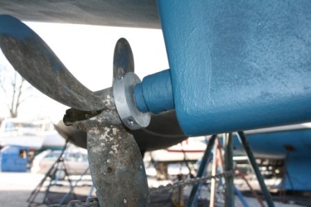

John O'Connell, Second Wind, Hull 84 "I had electrolysis on the end of my shaft about three years ago and can no longer screw a zinc onto the end. What I use now is a BD-25 donut zinc. It attaches on that small area of shaft between the prop and the hull. I've gotten two seasons on this zinc and probably could get three, except that I haul out every other year to paint the bottom and just change the zinc then. Bonnie Mitchell in Florida told me about it." He also provided the attached photos.

From a hydrodynamic standpoint, that is less than ideal.
