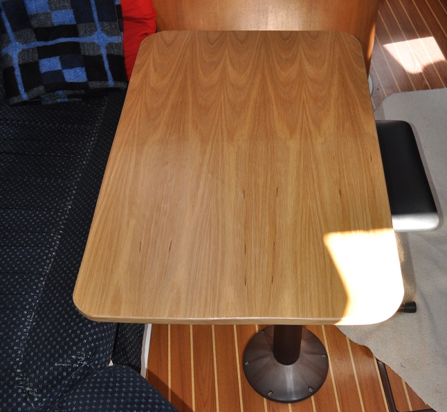

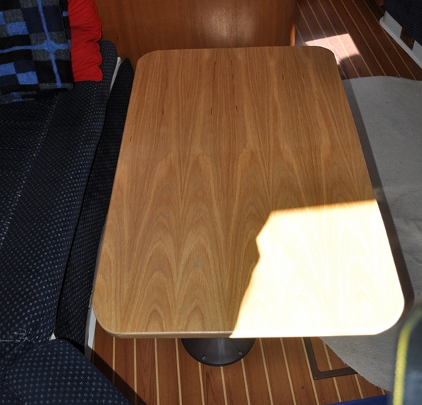

The Bench just about fits along the forward wall to port, when not in use. Barely. We usually toss it in the aft cabin ( read : Garage ) . We also found that neither of the stock table tops met our needs. The Large one is just too big for the two of us living aboard, and the cocktail table is worthless. So.. I made my own table "organically". We took a 2'x4' piece of MDF and started living with it. Once a week, we decided what to cut off. Over a month, we came up with an in between sized table that is perfect. Oriented one way, we can seat 5 ( 6 ) and still have room to serve, use head, etc. Oriented the other way around, it's just right for living on the port settee ( my side of the boat ).

Happy to help. I will also attach two images to show the two orientations.
Made out of MDF, topped with a veneer, then acrylic clear coat.
Dimensions: 36" x 24" ( actually an 1/8" less both sides )
Locations for the pedestal socket:
Near ( in photo ) 10" in from short side, 7.25" in from long side.
Far ( in photo ) 23" in from short side ( near ) , 9.25" in from long side.
Your measurements may well vary as the deck brackets are not always posted the same.
I will post this to the general group with the images.
Al
