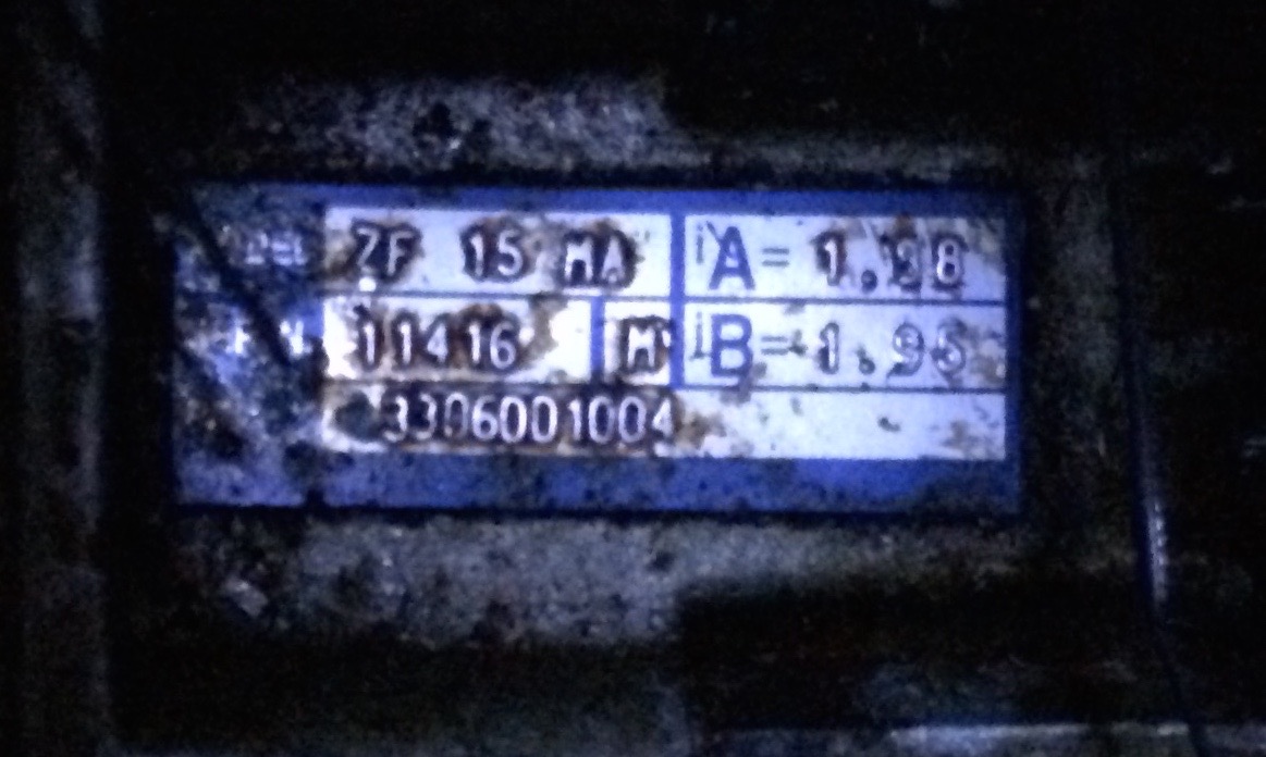

- Posts: 213
Re: Propeller Upgrade
Just found image of the plate from my 2003 gearbox.
ZF 15 MA
A = 1.38 (as best as I can tell although doc on web suggests could be 1.88)
B = 1.95
P/N 11416 M
Serial # 3306001004 (can't read it, but guessing this number must be serial number)
ZF 15 MA
B = 1.95
P/N 11416 M
- Hurth gbox plate.jpg (157.29 KiB) Viewed 3086 times
- Posts: 463
As Russ noted, there is a plate on the transmission. Our plate on a 2007 hull #422 shows:
Transmission: Hurth ZF 15MA (HBW 150A) P/N 3306001004 S/N 41625
Capacity: 0.50 qt = 2 cups (Dexron II or III)
Fwd. Gear Ratio = 1.875:1
Reverse Gear Ratio = 1.955:1
Prop. Shaft Rotation = Right Hand

- Posts: 68
- Joined: Mon Dec 06, 2021 8:52 pm
I have a 2007 C350. With a ZF-15-MA transmission. A= 1088. B =1.95. P/N 3306001004. I have the original three prop propellor unused if you are interested in it, I will sell and can ship to you. Steve Montgomery, s/v Salty. Deltaville, VA 757-561-7289. monty1221@icloud.com
