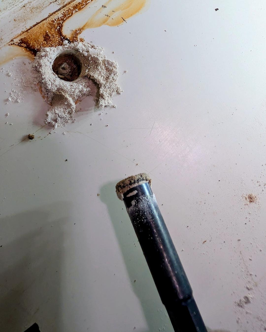

Sigh. No takers on my BOGO free offer. Anyway, here is the tool I used very effectively to remove sheared off sheet metal screws in the interior (by the way the replacement screws are #8 1" length.
It is the middle size core bit from Harbor Freight - sorry not at the boat. After coring directly over the screw shaft, I tapped it with a screw driver and hammer lightly and then with pliers unscrewed the remains. I then infilled the small depression in the gel/fiberglass with sealant. I tried using epoxy but it chipped a thin piece of the gelcoat (?) so any sealant will work..
