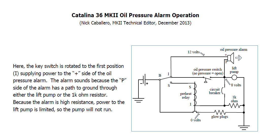

Here is another diagram which is easier to understand from another catalina site.

For all you electrical experts out there, What creates the supposedly 8 V shown in the diagram I found below on the Catalina 36 web site?
Buzzer Circuit 1.jpg (173.28 KiB) Viewed 40868 times
I measure about 9.5 to 10 V at that point on our boat. I thought the 8V was likely created by the 1K resistor circuit to ground, but when I disconnected that wire, I still measured 9.5V on the wire terminal lug. Is it coming from resistance in the buzzer, or from the ground path through the fuel lift pump. If it is from the path through the fuel lift pump, is that the reason the alarm is erratic, as the fuel pump could be in a variety of positions when you turn the engine off resulting in different resistances to ground and thus varying voltages seen by the alarm buzzer?
Our buzzer, like most of the others have noted, is very erratic. Sometimes it does not work at all, sometimes it is weak, and sometimes it is stronger. Never seems to be loud and 'alarming', but at least the Admiral can usually hear it.

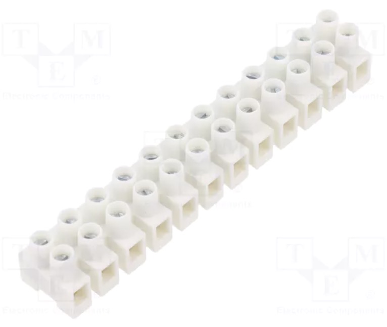

This is probably a long shot but one other thing to check is the terminal block behind the faceplate on the pedestal. I had issues with the buzzer emitting a faint, intermittent chirp from time to time. A couple of month ago I replace my faceplate which necessitated removing all the electrical connections. Afterwards I couldn't get the buzzer to consistently work. After many dead ends I traced it to a poor connection on the terminal block. I can't remember which wire was the culprit but started by tightening all the screws on both the input and output sides of the terminal block. Problem solved.
Be sure each wire is fully seated into the block and tighten each screw firmly. Here's what the terminal block looks like if you're not familiar -
