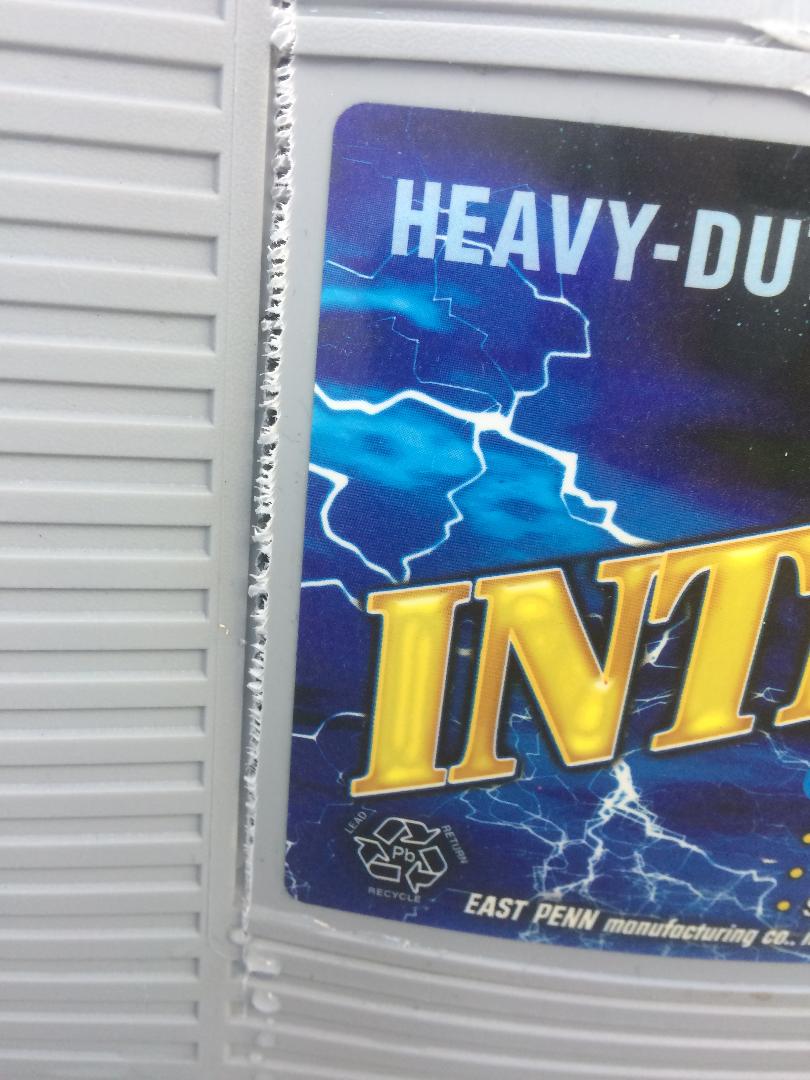

So now we have culinary water. The hose fixed. Closing boat up. Looked st batteries this morning. Bad bad news. Found out why no house bank.
They where dry boiled overcharging. So I added water. Bad idea. Turns out one has a split top to bottom. Water came out all contained in battery compartment. I had to remove one of them so I could clean up mess. So now it’s two new golf cart batteries. These are AGM Did some program in the inverter /charger cause thi?
Can I replace with flooded?

Fiftybucks
- Posts: 84
- Joined: Thu Sep 26, 2019 2:10 pm
- Location: sold
Re: Newbie heads out
Thx in advance. I did not know off hand. Hand to research. The two bad batteries are 4d AGM. 2000 watt Xantrex inverter / charger. 1 group 31 AGM start battery inn great condition. I thought the I/charger could sense the type of batter and change program. Maybe I have to change. I’m definitely going with flooded. But is it ok to mix? Should I get a flooded start battery so they are all the same? It was silly to set out without knowing and trusting survey. I have pics but once again too large.
On the float voltage.
I put a multimeter on and charger was at 13,85. After 2 hrs. The volts level showed good on the battery test rocker switch (in the green) but upon 1 attempt to start engine. just a click and dead. Engine start batter good. I’m not sure what all the.numbers are that the Xantrex cycles thru. Some are negative unless charging for some time.

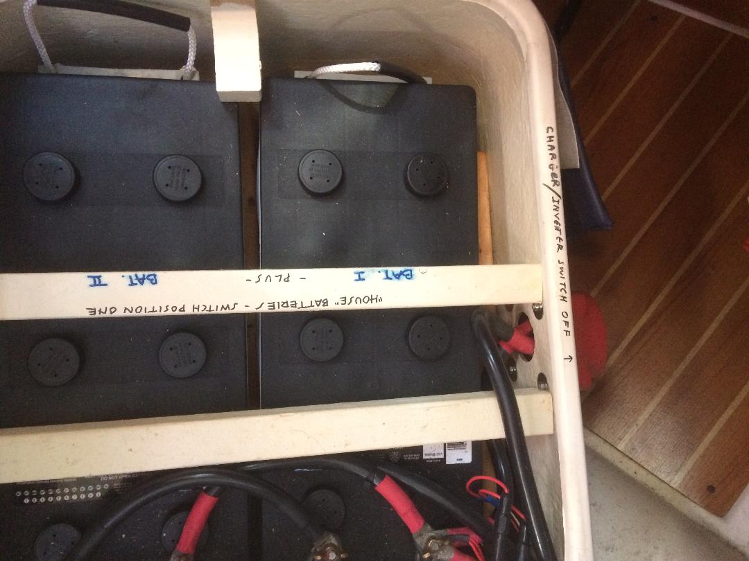

With the location of the batteries under the nav seat (read that in the living area) I would suggest AGM's which do not out-gas except under extreme over-charging.
How did you add water to the old AGM"s???
Yes, the Xantrex 2000 is programmable for: Battery technology, battery bank size (in amp-hrs) and temperature (unless you have the optional battery temperature probe).
As far as mixing battery technologies, best answer is NO. Acceptable answer is that the charging parameters are close enough between wet cell and AGM.
Where is your start battery located? And, if it is old, best advice is to have all batteries of same age and same technology.

Yes they are under the seats.
I popped the caps off then unscrewed a hexagon plug with o ring. Shined flashlight into cell dry cell plates. Then added distilled water using funnel. This was only on 1 st house battery. Which all the water I added leaked out. So AGMS don’t have water? They are supposed to be dry plates? Forgot. Multimeter showed 10.44 volts on either before touching anything.

there was a question a bit back on how many hours... about 950 now
i did not get maintenance docs with purchase but some other docs... had complete oil change ... filter... racor fuel filter, all professionally done at sneads... no complaints there. but the coolant was pure water...
on the start battery... it is in the next forward under seat compartment.
im not sure on the wiring... not my strong point but learning fast...
all have to understand, the 2 4ds are ABSOLUTELY TOAST !!! cracked and bulging sidewalls.. from top to bottom.
they will have to be replaced with what... i'm open to suggestions. maybe 3 3 golf cart G series?
What was the original battery configuration? where were they located.. did they come with AGMs?
I want to cruise and have the fridge run medium cool overnight. I'm not sure what that is load wise, but enough house battery bank to cover. almost no other draw, except anchor light, intermittent interior light. maybe 4ds are too big?
