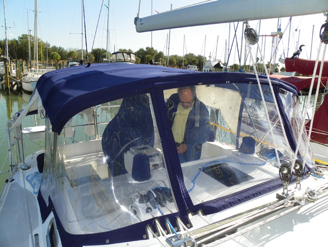

We have a 'tall' bimini in that it is the same height all the way to the dodger. It's great if you happen to be a little taller. It also provides better visibility. The down side is that if creates more wind resistance if racing happens to be your interest.
- bimini.JPG (147.49 KiB) Viewed 27673 times

I believe the factory installed C350 canvas was all made by Lippincott Marine in St. Petersburg, FL
http://www.lippincottmarinecanvas.com/
In our case, the eisenglass stops a couple of feet behind the cockpit hatch (about the forward edge of the table). The center section above the cockpit hatch rolls up to let the breeze in or can be easily removed. Actually the whole thing is easily removable as it just held on with zippers and snaps. We have zip in suncreeens that come down a couple of feet from the bottom of the bimini and go all the way around the back, although we almost never use them. The bottom line is you can get almost anything you want from a good canvas maker, but I would think they would need to be local if you want anything remotely custom. Maybe not, you could give Lippincott a call and see what they say.
If I was doing it over, I would not have them cut a separate slot for each line you see in the picture. Those small tabs in the canvas have a tendency to tear, and each of them requires its own snap to hold in place. I think a single slot that encompassed all the lines would be sufficient. It might let in a little more air or rain, but I wouldn't think it would be too bad.

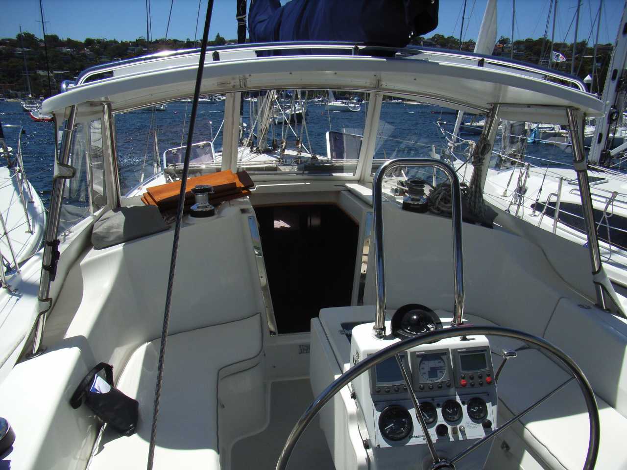

If you have thought "hard dodger", I highly recommend it. The factory did sell them as far as I am aware, ours came with the hard dodger and semi-rigid polycarbonate windows which are superb compared to canvas dodger windows. It also gives you a robust mount for solar panels, very rigid attachment for in-fill canvas to bimini, and excellent handholds all around the cockpit for going forward.
I don't know who made them, the windows were made by Barrett Enclosures of Seattle, who are now Rainier Windows (also Seattle), they have the patterns for the C350 windows.
