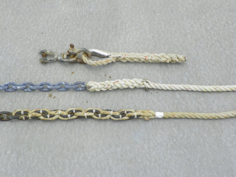

Here's a picture of the new elongated splice I put on our chain. The upper piece is the shackle/thimble/eye splice arrangement that we had previously. Clearly it wouldn't run through the windlass. The second line is our second anchor with a standard backsplice. I think it would probably run through the windlass, but as you can see it is larger in diameter than the elongated splice.

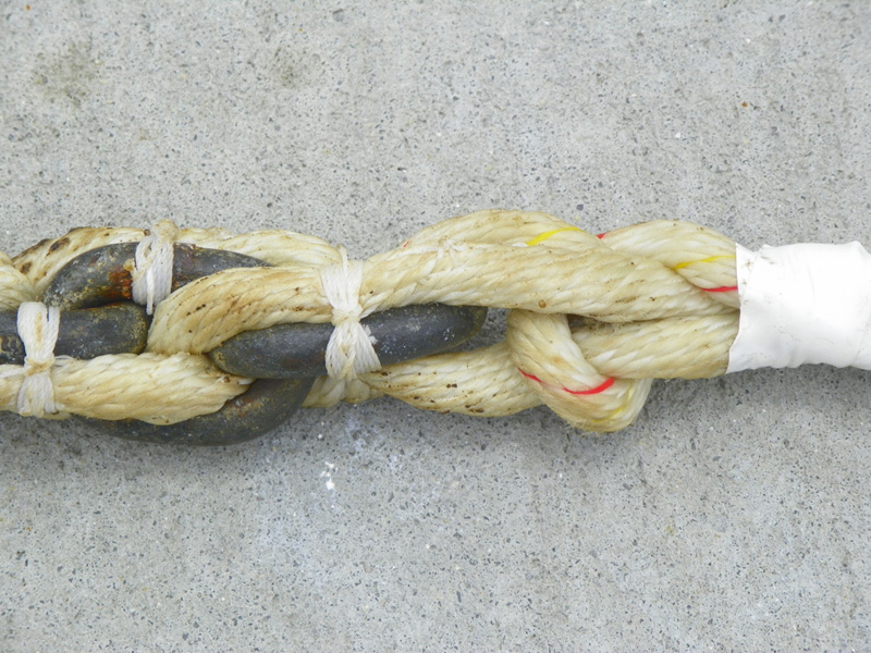

From everything I have read, the elongated splice should be stronger than the backsplice as it does not bend the strands as much when attaching to the chain. My only concern is that between the end of my unbraided 3-strand and the first chain link, the strands are essentially straight independent lines as seen in the second picture. I did add an overhand knot between 2 of the 3 strands in this area that wasn't called for to help in keeping the 3-strand from untwisting all the way up the rope, but it still looks pretty loose to me. Possibly I didn't draw the first weave up tight enough, but I suspect once you put load on it, this area will expand. I don't know.
- Chain Splice.JPG (184.56 KiB) Viewed 14954 times
- Chain Splice2.JPG (218.25 KiB) Viewed 14954 times
