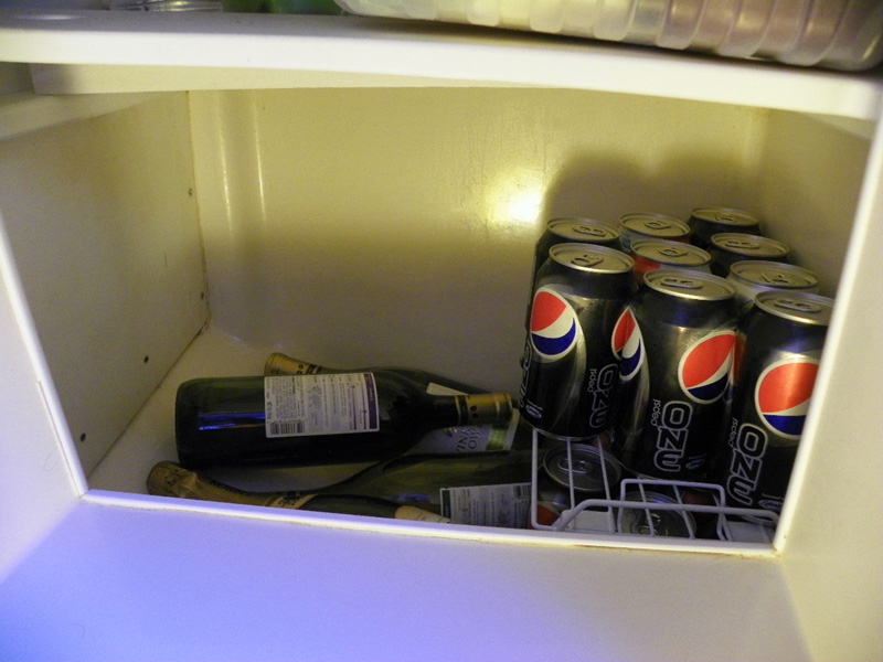

Here's the way the fridge usually looks as soon as we leave the dock.
Stock Fridge2.JPG (136.46 KiB) Viewed 11585 times
Stock Fridge.JPG (147.82 KiB) Viewed 11585 times

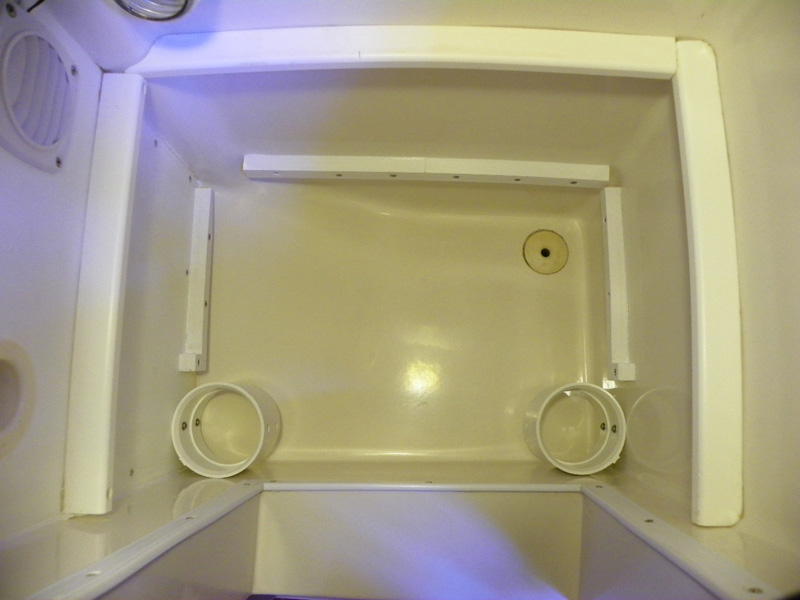

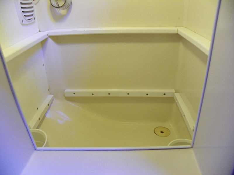

Here are the new shelf components:
I also took the time to drill some additional 1/4" holes behind the new supports and filled with as much DAP low expansion foam as I could while I was at it. I don't know whether it will help with cooling, but I figured it couldn't hurt.
The 2 wood parts were used as spacers to locate the new supports from the existing upper shelf supports
New Shelf Parts.JPG (140.31 KiB) Viewed 11585 times
Installation of the Shelf Supports
Shelf Supports Installed2.JPG (102.88 KiB) Viewed 11585 times
Note the 2 "Wine Bottle Holders" from 3" PVC pipe couplings
Shelf Supports Installed.JPG (105.04 KiB) Viewed 11585 times

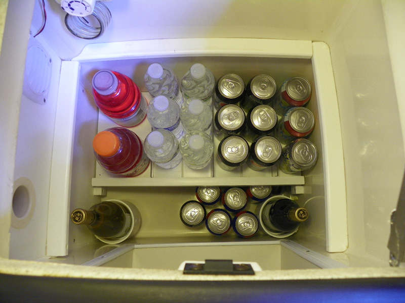

The new lower shelf with dividers
New Lower Shelf.jpg (94.18 KiB) Viewed 11585 times
New Shelf1.jpg (131.2 KiB) Viewed 11585 times
New Shelf2.jpg (178.38 KiB) Viewed 11585 times
New Shelf3.jpg (155.55 KiB) Viewed 11585 times
