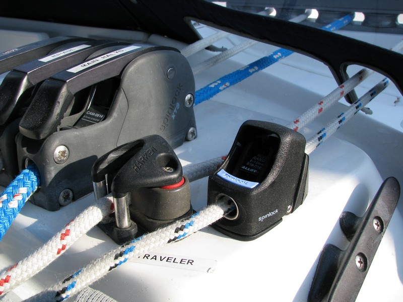

Posted: Fri May 30, 2008 7:17 pm
by EvenKeel
I finally mounted my Spinlock clutch today. It was nice that it fit the holes for the existing cleat, but the mesh bags for stowing the halyards etc interfered with handling the furling line, and it seems difficult to haul on the line without popping the clutch open accidentally-- which could be nasty in a heavy wind. So I moved it to the horizontal area just to outboard of the traveler cam cleat at it's fair lead. After moving the furling line to the outboard-most sheave in the traveler, the Spinlock was perfectly inline between the sheave and the winch. Works extremely well there! There is a metal backing plate under this area, but that allowed me to tap threads into it and use bolts instead of screws to mount the clutch.
This is a cheap and easy addition that makes a world of difference. I was out in 25 knots solo today and it made handling the genny much easier. Thanks to whomever first thought of this.
I took a picture of it. Email me if you want to see it. gbenzon{at}benzonresearch{dot}com
Gary

Picture of alternate clutch location
Posted: Thu Sep 25, 2008 9:58 am
by EvenKeel
I've had a number of people e-mail to ask for a picture of the Spinlock clutch mounted on the horizontal area next to the traveller cam cleat. This has worked out extremely well for me.
I'm going to attempt to include the picture below. You'll notice that I left the original cleat in place. I've used it to back up the Spinlock clutch when heavy storms were forecast.
Gary
Even Keel II
