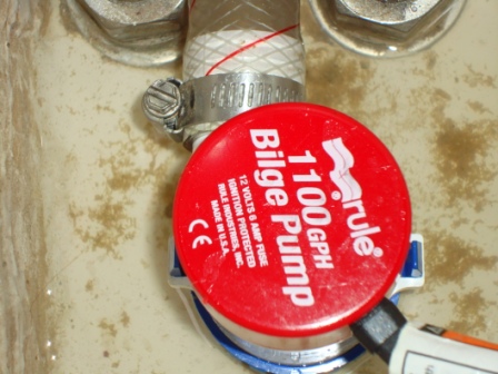

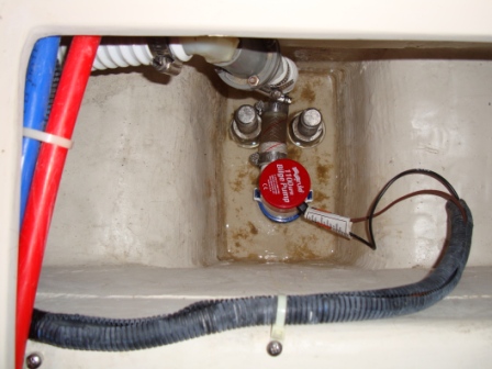

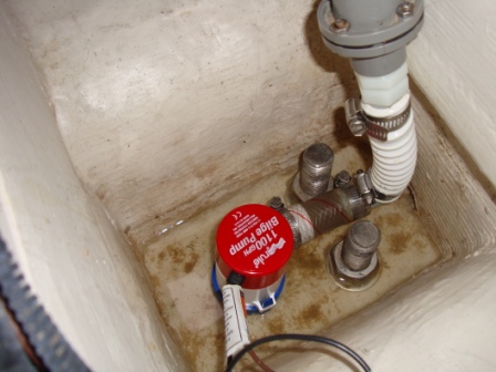

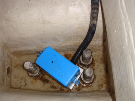

We are undertaking the correction of our ongoing bilge pump problem this weekend. Luckily, we have solved all of the leaks into the bilge over the last 3 years, so currently the only water in the bilge is from the weekly cleaning of the raw water filter for the AC and then flushing the bilge with fresh water.
Here's the problem: Since taking deliery of our boat in October 2008, the bilge pump would either not come on or would come on but not pump like Barry mentioned in an earlier post. Here are the various steps we have taken over the last 3 1/2 years:
-dealer changed out the check value
-dealer added a "basket" to the bottom of the pump (why wasn't it there to begin with??)
-dealer raised the float switch.
-dealer supposedly changed out the bilge pump
After each of these tweaks, the pump would work for a while. When it stopped working, we would do one of the following and it might/or might not get the pump puming again:
- rattle and shake the checkvalue and hose
-hit the top of the pump with the end of whatever tool we had handy
-hit the top of the float switch with the end of whatever tool we had handy
-pull the pump up out of the basket and shake it
-turn on "manual" mode at the nav station electrical panel
We installed a new bilge pump a copule of months ago. Worked great! Then, guess what??? Sometimes it comes on and sometimes it doesn't. Sometimes it just comes on and runs, but doesn't pump. Sometimes it won't come on until we run it on "manual" model, and sometimes it doesn't come on then either.
Same thing as the old pump. Sooooo, I guess we've been lucky that the boat has always been floating when we get to the slip, but I think our 9 lives may be up at this point.
Need the collective advice of C350 owners on how to work through the process of elimination to solve this once and for all. Please help!

MorningStar
Re: Bilge Pump System
I too had a problem with the bulge pump not coming on when it should and cavitating because the switch was in another compartment with water when the pump was in another with no water. The connection holes between compartments were slightly covered over with fiberglass the limited the flow of water to slow transfer. I solved my problem by replacing the pump switch with a electronic in the same compartment as the pump. This solved the cavitation problem. I also opened up the connection between compartments with a little drimmel, grinding away the fiberglass that was narrowing down the hole. All works fine now. I did this about 6 years ago after receiving the boat.
Hope this helps.
