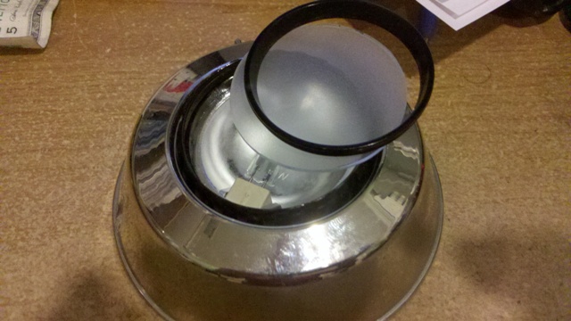

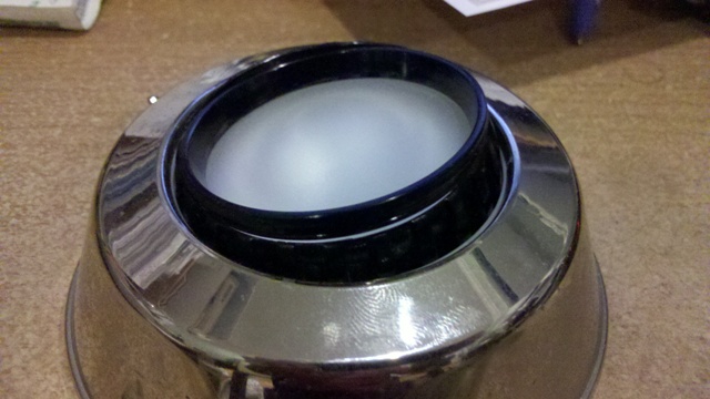

If you run your fingernail on the outside of the black plastic, you will feel the lip of the ring that holds the glass which covers the bulb. It took me a while too to understand what it took to remeove the bulb. I will try to attach some photos.

Mark, thanks very much for the reply and photos. I was able to run my finger nail between the two halves of the black plastic ring and split them - the lens dropped out as predicted in another post, and voila - access to the bulb! The part I had not understand is that the two halves of the ring are an upper and lower half, not left and right. I put in a 10w bulb, but could not read the wattage on the dead bulb. Anybody know what the correct wattage is?

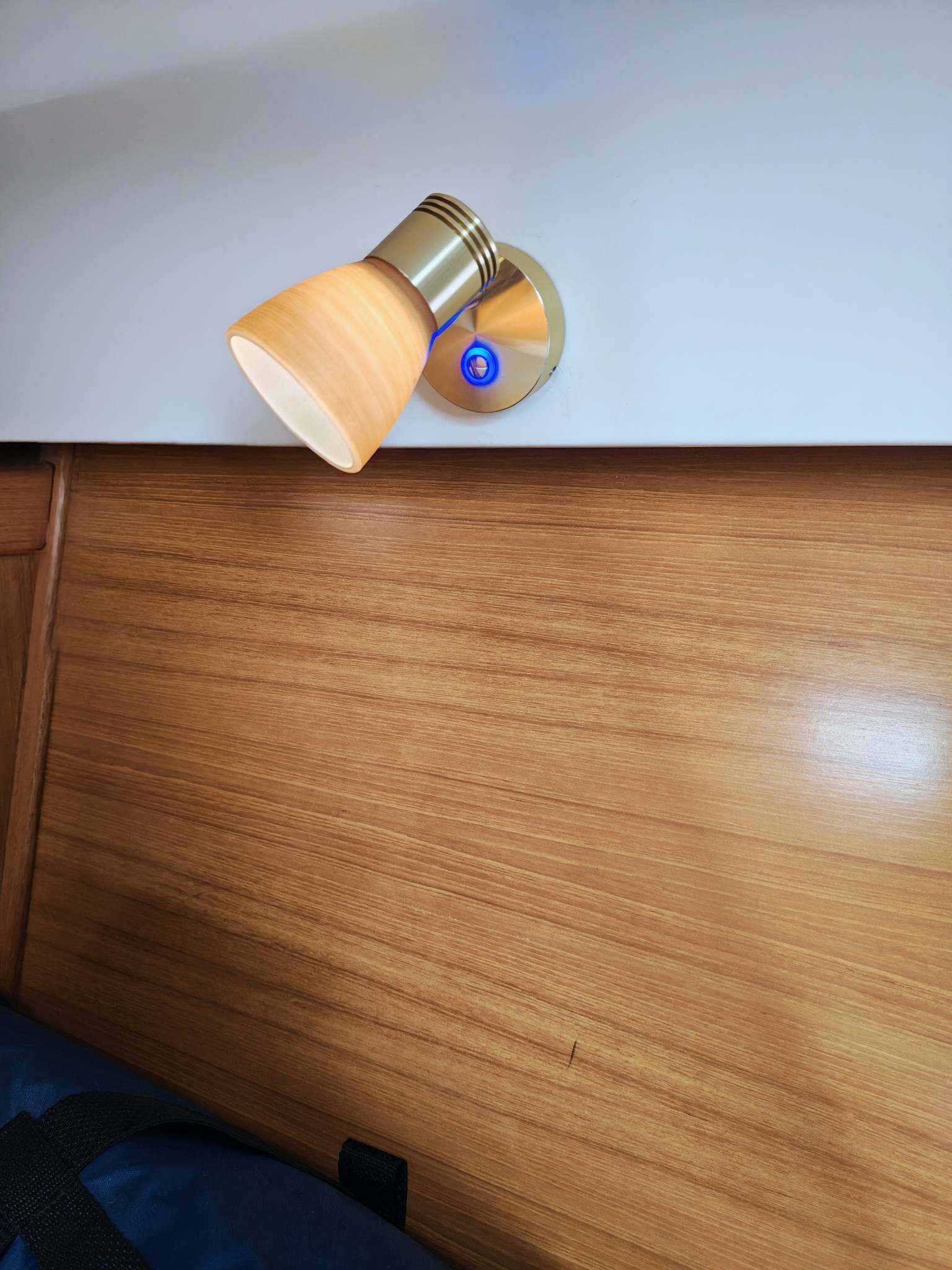

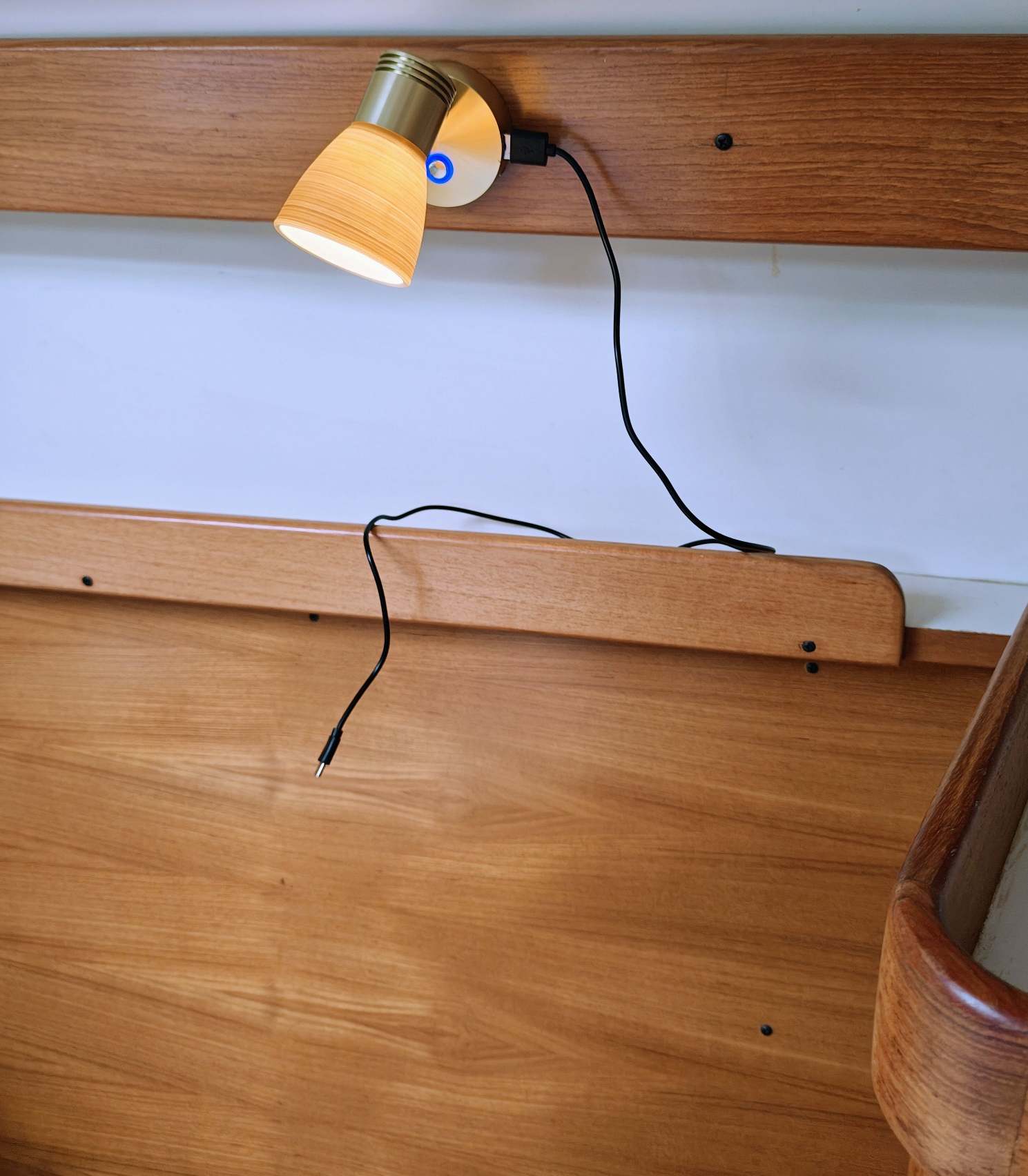

Rather than start another thread I thought I would ask on this one. Has anyone replaced the whole puck with something similar but slimmer and closer to a flush mounting? I see West Marine has some options that sort of look ok but have no switch included so it would be every light would come on with panel switch activated and that is impractical.
Re: Replacing interior light bulbs
I haven't had any luck with finding a slim puck light replacement (with switch) but wanted to share these photos. I put these in last week and think they look nicer than the chrome originals. The USB A ports on the two I have in the V berth are great for charging phones overnight.
- IMG_20240930_151529664_HDR_AE~2.jpg (157.43 KiB) Viewed 15716 times
- IMG_20240930_144058630_HDR_AE~2.jpg (147.7 KiB) Viewed 15716 times
- IMG_20240930_144035647_HDR_AE.jpg (237.07 KiB) Viewed 15716 times
