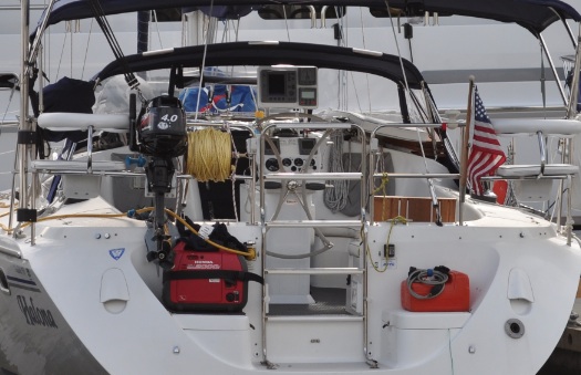

We have used the EU2000i now for two full seasons. It has met our every need. We do not store it in a locker, nor do we store gasoline in any locker - just seems to be asking for trouble ( explosive gas fumes and all that ). The valve to allow the tank to "breathe" when running is not the only vent in the generator fuel system, so even if you closed that valve, you will still have gas fumes trapped below decks. We store our generator on the port aft locker, complete with 2" webbing straps, a raincoat and a large gauge chain and lock. Even in the worst of weather and waves, the genset never budged. We don't have to move the system to fire it up and don't have to lug it around decks every day. The only caveat that we would offer is anecdotal : a number of folks with Honda generators have told us about valve problems when using non-clear fuels, e.g. those fuels with Ethanol added. One individual went through two generators ( under warranty ) with seized valves traced back to Ethanol - he eventually went to a Yamaha unit despite the noise - where he was at, he could not get clear gasoline. When in doubt, get your generator fuel where they fuel up seaplanes - no additives allowed there.
Al
Al
- Posts: 88
Re: Honda 2000i
Decided to add a photo to my last posting, showing the placement of the Honda.
Al
Al
- GensetHome.jpg (71.97 KiB) Viewed 19904 times
- Posts: 88
Re: Honda 2000i
oh.. just gotta add two more points. when we had our Tanzer 22 surveyed, the surveyor said/claimed that it was a violation and a non-insurance clause to store gasoline ( in any type of container ) with direct air communication to living spaces and / or spark and fire. She wanted us to store our outboard fuel other than in the lazarette. As all of the spaces on the C350 do communicate with the living spaces and we have stoves and igniters as well as a non-explosive atmosphere rated battery charger - I just think that stowing a generator in a laz or even in an aft well is just not safe.
point two : CC the moderator asked what was up with the yellow spool of line above the genset - that's our stern tie line.
al
al
