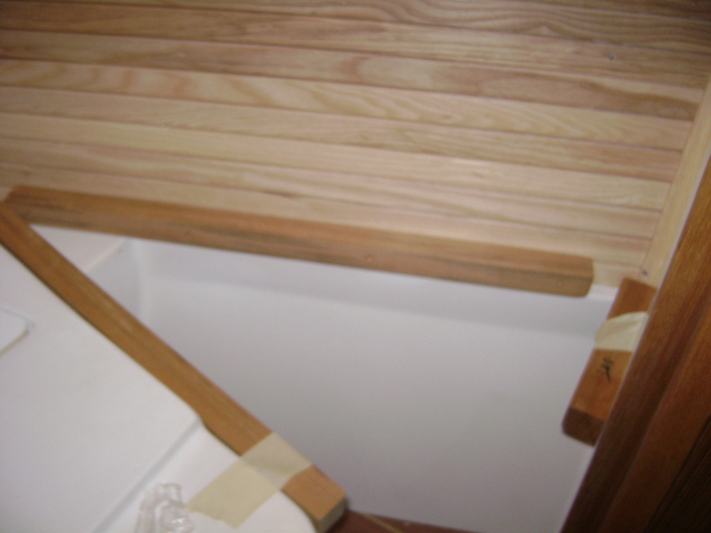

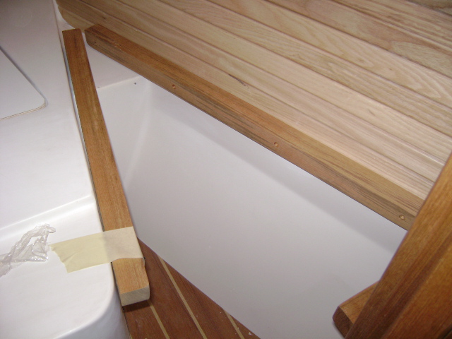

Can you post some pictures of where / how you mounted the supports, when you have a chance? I have had the bolsters for 6 months and haven't figured out which teak piece should be used where...

Hope these help I have 6 pictures so if feel comfortable providing an email address, I can send all of them
Catalina did not bore holes in all the wood they sent, so I had to get a special bit and drill myself
These pictures are from a Catalina dealer or FL I think when I installed them I switched them around There are 2 styles, so if they dont fit you might want to contact FL to ask
