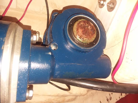

Our Maxwell windlass is also leaking. I can see rust developing on the bottom end of the shaft and dripping into the forward cabin. The original poster mentioned a 'weep hole in the shaft casing'. I am not sure I see this hole, but was concerned that in order for water leaking at the shaft seal under the cone to run all the way down the shaft into the cabin, that every seal along the way down the shaft would also have to be leaking and there might be water in the oil. Can anyone provide more information about this 'weep hole'?
Maxwell Windlass.JPG (44.18 KiB) Viewed 27480 times
Also can anyone provide any clarity on which direction the shaft seal under the cone is installed? Cone side up or flat side up?

The leak is most likely coming from the ring seal under the drum and clutch components. Remove the drum, clutches, (basically all the moving parts you can remove from above deck) and you will find the ring seal which goes around the shaft under everything else. I have found that every year or two this seal begins cracking and eventually splits letting an alarming amount of water into the boat over a prolonged rain event. You should be pulling the drum and all parts above deck annually to clean and grease anyway and replacing the seal is no big deal. This seal does allow water to work it's way down and seep through the bottom of the windlass but as long as you don't see oil leaking my bet is that it is the ring seal. As I recall you can order this seal from Defender for less than $10, and I keep several spares on hand. I believe the part number is SP708 but I would check in your manual to be sure.

I installed it with the cone facing upward
Re: Windlass service is easy, and I found a leak
Posted: Tue Nov 13, 2018 11:16 am
by william vanwagoner
I looked at the manual and it shows the widest part of the seal on the bottom, which I recall is sort of a flap that presses down on the area around where the shaft disappears under the deck.
